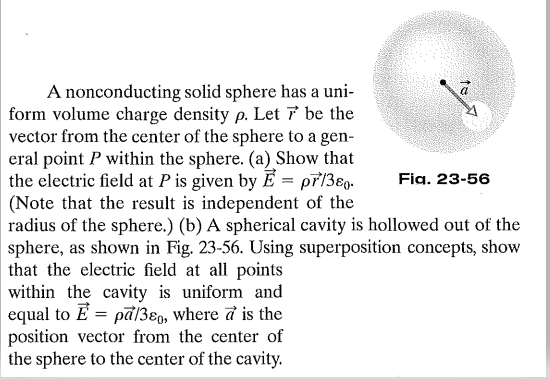

A nonconducting solid sphere has a uniform volume charge density p. Let r be the vector from the center of the sphere to a general point P within the sphere. (a) Show that the electric field at P is given by If = p7I3so. Fig. 23-56 (Note that the result is independent of the Problem 73. radius of the sphere.) (b) A spherical cavity is hollowed out of the sphere, as shown in Fig. 23-56. Using superposition concepts, show that the electric field at all points within the cavity is uniform and
equal to If = pa/3so, where a is the position vector from the center of the sphere to the center of the cavity

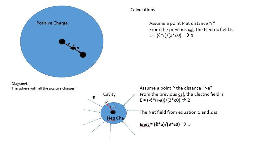

Ok, so this is my understanding, please correct me if i am wrong, how the charges are replaced will be something like this.
The calculations are something like this.
Are the above understanding and calculations correct? Please advise.
The diagrams are difficult for me to understand in detail. The equations are correct (so long as we agree that a,r,and E are vectors) and so I think you get the idea. A surprising result (to me at least) but looks correct. The superposition idea (and the similar method of images) are very very useful, so understand them well.
