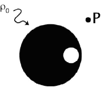

You're misunderstanding the problem. :) The cavity is shaped something like this:
With the axes aligned a bit differently, and different numerical values for the radius of the cavity and the center-to-center distance of the cavity and the charged sphere.

I don't know how you've solved the problem, but I suggest that you do the following:
Solve it again, but this time give the cavity a parametric radius, and give the center-to-center separation a parametric radius as well. Don't align the center-to-center vector with any of the axes either.
In other words, try and solve the problem in the most general case. I assume the approach you've taken is to treat the cavity as an area that has super-positioned positive and negative charge densities of equal magnitudes (Yielding 0 net charge).
If you take the vector sum of the 2 sources of E-Field (Filling in the cavity with positive charge and negative charge means you only need to deal with a whole positive sphere centered at the origin, and a negative sphere centered at the center-to-center separation distance) you find that it is constant both in magnitude and direction.
The E-Field doesn't just point in the y-direction, it points in the direction of the center-to-center separation!
One could even guess that due to the axial symmetry of the situation, that the E-Field would be symmetrical with respect to rotation about that axis.
A field constant in magnitude and direction, however, is an incredible result! :)
