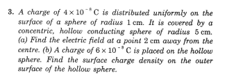

Let's say I place a positive point charge inside a hollow conducting sphere. If we take a Gaussian surface through the material of the conductor, we know the field inside the material of the conductor is 0, which implies that there is a -ve charge on the inner wall to make the net enclosed charge 0 and a +ve charge on its outer wall. If I remove some electrons from the sphere, my textbook tells me that the +ve charge on the outer surface increases. Does this mean that the Electric Field inside the conductor is not equal to 0?
If it still is equal to 0, can someone please help me understand why? When I remove some negative charge from the conducting sphere's material, the positive charge on its outer surface becomes greater in magnitude, which to me implies that there is an Electric Field inside the conductor.
I think I could also be misinterpreting the answer, and the author could be trying to say that the field inside the conductor was 0 before the extra charge was added to it, but then again, the author has stated that there can be no electric field inside a conductor in electrostatics. I understood why that statement is true, but when I add extra charges, I'm really not sure.
Thanks a lot for taking time to help :)
If you put the charge inside, the charges of the conductor in the static state rearrange such there's no electric field inside the conductor, and there must be a surface charge distribution at the inner and the outer surface. From Gauss's Law you get that the inner surface must have a total charge of ##-4 \cdot 10^{-8} \text{C}##. Nothing changes on the inner surface of the conductor when putting the additional charge of ##6 \cdot 10^{-8} \text{C}## on the outer conductor but the additional charge distributes over the outer surface. Which thus must have a total charge of ##+10 \cdot 10^{-8} \text{C}##.

Nothing changes on the inner surface of the conductor when putting the additional charge of on the outer conductor but the additional charge distributes over the outer surface. Which thus must have a total charge of .
But wouldn't the extra positive charge create a net electric field pointing inwards in the conducting material? Or am I thinking along the wrong lines?
Gauss's theorem says what is inside of enclosure matters, not outside. For example electric field is zero inside a sphere that has charged surface.
This is correct. So now apply Gauss’ law. What does Gauss’ law say will happen?

If I take a Gaussian surface through the material of the conductor and the extra positive charge is outside the radius of this surface, the Electric Field is 0 since the net charge enclosed by it is 0. If I take a Gaussian surface with a radius larger than that of the larger sphere, I find that the flux is not 0, and hence the Electric Field is also not equal to zero. I'm pretty sure I'm right but I could be wrong here too.
You are exactly right!
