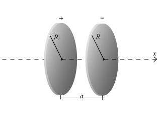

Consider two thin disks, of negligible thickness, of radius R oriented perpendicular to the x axis such that the x axis runs through the center of each disk. (Figure 1) The disk centered at x=0 has positive charge density η, and the disk centered at x=a has negative charge density −η, where the charge density is charge per unit area.
What is the magnitude E of the electric field at the point on the x axis with x coordinate a/2?

I can see that the [itex] R^2 / x^2 = \arctanθ [/itex] but I do not understand where the [itex] \left( x - a^2 \right) [/itex] comes from or how to continue from here. Thank you.

Hello brystephor, :welcome:
did you try to substitute your a/2 in the general formula ? surprise !
I did not do this. I am not sure where to substitute it in for or why I would do such a thing. Clearly a/2 is the point between two disks, but I do not know which of the variables in my general equation I would replace with a/2 or the formula that Mastering Physics gave me.
What does ##x## represent in the formulas you have written?
