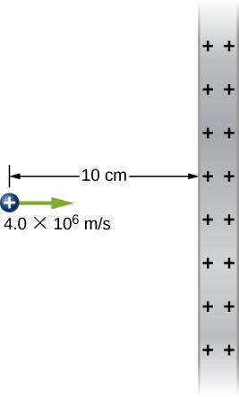

Well I did not state the full problem, but if it helps here's an image. Part of the problem was finding the electric field to find the force, and once I find that I know how to continue. So the proton is not between the two sheets which form the plates.

OK, that helps. Point P is not between the faces of the plate. In the problem statement, you say that ##\sigma## is the charge density of the plate. Does that mean that each face of the plate has the surface charge ##\sigma##?
I think it would be helpful to state the relevant part of the problem word for word.
See the paragraph for item 3 here: https://www.physicsforums.com/threads/guidelines-for-students-and-helpers.686781/
The whole problem is:
From a distance of 10 cm, a proton is projected with a speed of v = 4.0 × 106 m/s directly at a large, positively charged plate whose charge density is ##\sigma = 2.0 × 10^{−5}C/m^22##. (See below.) (a) Does the proton reach the plate? (b) If not, how far from the plate does it turn around?
So from my understanding, ##\sigma## would be the surface charge of each plate.
Thank you. You have the right idea that you sum the contributions from each surface (sheet of charge). Your expression for E in the "attempt at a solution" is correct, although I'm not sure what the unit vector ##\hat r## denotes?
##\hat r## would be the direction of the field.
And what direction would that be?
In this case it would be in the ##-\hat i## direction acting on the proton.
OK. Good. I think you have it.
