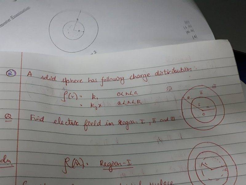

A solid sphere has surface charge density, Rho (r)
Rho(r) = k 1 ( 0 < r < a)
k2 x ( a < r < R)
2)
Find the electric field in all region i.e 1) r < a and 2) a < r < R and 3 ) R <

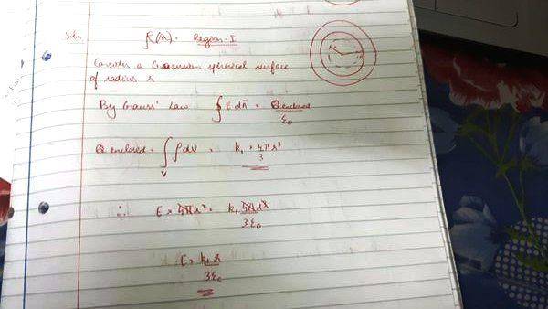

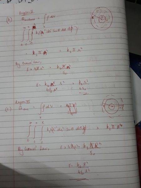

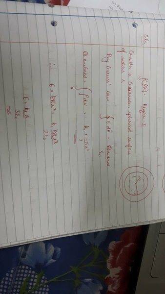

The attempted solution and the question with the diagram is attached below
Could the answer be verified particularly for region 2 ?!
<< Mentor Note -- fixing up picture some... >>

What you describe is not a surface charge density. It is just a charge density.
Even with the mentors cleaning up your image it is difficult to read (and impossible to quote). I suggest that you type it out and explicitly flesh out your argumentation for each step.
vtv said:
k2 x ( a < r < R)
What does this mean? Should it be just k2, or perhaps k2r?
