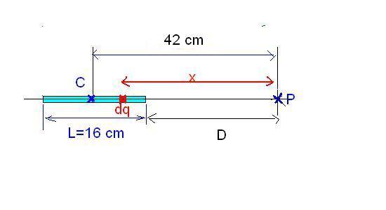

A rod 16.0 cm long is uniformly charged and has a total charge of -21.0 µC. Determine the magnitude and direction of the electric field along the axis of the rod at a point 42.0 cm from its center.
The equation I am advised to use is, [itex]\vec{E}=k_e\frac{\lambda l}{d(l+d)}[/itex], which becomes [itex]\vec{E}=k_e\frac{q}{d(l+d)}[/itex]. I understand how the numerator is formed, but how the author comes up with the numerator is something I am a little confused about. Could some possible explain how this formula is developed and what precisely it means?
