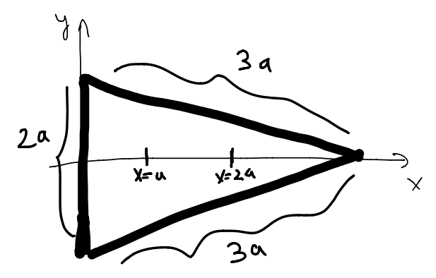

Consider the triangular-shaped wire in the picture. The base is of length 2a and is along the y-axis, and the two sides are of length 3a each. The wire is uniformly charged with charge density (per line) [itex]\lambda[/itex].
Find the electrostatic field at all points [itex]\vec{x}[/itex] = x[itex]\hat{i}[/itex], where x [itex]\in[/itex] [a; 2a]. There is no need to evaluate any integral. Your final answer must specify the components of the electric field through integrals such that (assuming the numerical values of the integrals are known) the final answer depends only on [itex]\lambda[/itex], a and the constant [itex]\epsilon _0[/itex].

Most of this problem came pretty easy to me. Some symmetry arguments made, etc.—I found the e-field contribution of the base (w/ length 2a), and proceeded to try to find the e-field contribution of one of the sides (I know the [itex]\hat{j}[/itex] components cancel, and the [itex]\hat{i}[/itex] component is just double of the contribution of one of the sides.
The issue comes up when trying to generalize the distance and direction from some point between x = a and x = 2a and a point on the diagonal wire.
My process begins like this ([itex]\hat{r}[/itex] is the direction from a point on the wire to the x-point, and r is the distance):

Now, I've got to find r and [itex]\hat{r}[/itex]—and relate da to that. This is where I get snagged up.

The last step is due to the fact that the [itex]\hat{j}[/itex] components cancel one another. First, is this... correct? Does it make sense to do that, and, eventually, have to integrate with respect to xw? Or am I over-complicating things?
Also, I can't figure out for the life of me what da is. I know it's some infinitesimal amount of wire, but how can I express that mathematically? I end up doing something like [itex]\sqrt{dx^2 + dy^2}[/itex] which I'm pretty sure is wrong.
Maybe... use the angle made with the vector from the point to the wire and the x-axis, and use that angle to express the infinitesimal length of the wire (angle multiplied by arclength)? I feel like I'm missing something very simple here (there usually is -_-), but I've been mulling over this problem for a while and can't figure it out.

Maybe, but it was very hard to follow because of the way you've assigned da, x, y, xw. Looks easiest to me to take elements that have coordinates (u, ±v), measuring u from the right hand vertex. I'll measure x from there too. v = αu, where α=√2/4. Length of element is 3αdu. Field in x direction from pair of elements (one above, one below) is ## \frac{6\lambda \alpha du}{4\pi\epsilon _0 ((x-u)^2+\alpha^2 u^2)} ##
How did you get the [itex]\alpha = \frac{\sqrt{2}}{4}[/itex] and [itex]v = \alpha u[/itex]?
I keep ending up with [itex]v = -u + 2\sqrt{2}a[/itex]—which makes my calculation of an infinitesimal length of wire really... uh... ugly.
As I said, I took the origin as the pointy end of the triangle for simplicity, and with +ve u as being to the left. What (in (u,v) terms) would the equation of the line of the upper wire be?
Whoa. There's that [itex]\frac{\sqrt{2}}{2}[/itex]
Geeze. That... that makes the problem so much easier. And one could use two different coordinate systems for the different parts because the value of the integral should come out to be the same anyway.
Also, approaching the problem as I was (w/o altering the coordinate system) I should be able to express [itex]dl[/itex] (changed it to [itex]dl[/itex] from [itex]da[/itex], since that's easier to follow) in terms of the ratio between the total length of the wire and its total x-coordinate (without having to change coordinate systems or anything). That is, [itex]L = \frac{3}{2\sqrt{2}}u[/itex].
Which means that [itex]dL = \frac{3}{2\sqrt{4}}du[/itex] (in the old coordinate system).
