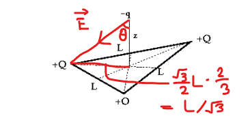

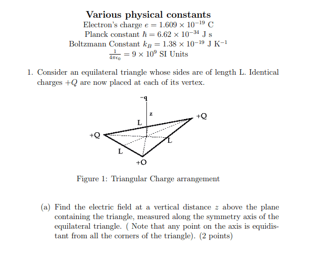

## d^2 = z^2 + \frac {L^2} {3} ##
## C ## is coulomb constant
since the point is symmetric, only the vertical component of the electric field remains. So,
$$ E = 3 E_y =3 \frac {C Q cos \theta} {d^2} $$
$$ E= 3 \frac {C Q z} {d^3} $$
thus part (a) is done ( i think).

For information, note that the question states that the reduced Planck constant (##\hbar##) is ##6.62 \times 10^{-34}## Js. That is wrong because ##\hbar = \frac h{2\pi}## and ##h=6.63 \times 10^{-34}## Js (not even ##6.62 \times 10^{-34}## Js). However the Planck constant is not required in the question!!!
It may also be worth noting that system described is unstable (c.f. a sharp pencil balanced on its tip). The negative charge will be attracted to one of the positive charges unless it is constrained to the symmetry-axis. (As explained by Earnshaw’s theorem if you want to look it up.)

Both ##z## and ##d## are variables. You've already said ##d^2 = z^2 + \frac {L^2} {3}##. Your equation for ##E## should be in terms of the single variable ##z##.
