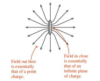

Field magnitude can be interpreted as density of the field lines, right? A cylindrical Gaussian surface gets flux through its circular end caps only. For both types of surface, we're usually talking about a field that is perpendicular to the surface.
Compare a very small tube with one line of flux shooting through perpendicularly, with a very long tube with one line of flux shooting through perpendicularly. In other words the density of the field lines is the same in both situations at the end caps.

I suppose I may not have explained myself well, but going off of your last paragraph where the size of the tube does not matter, how could we not apply this to a flat surface on a charged conductor? Wouldn't the electric field perpendicular to this flat part at any distance be the same, regardless of whether it's infinite or not?
Basically in the finite case (like a charged disk, or L*W square), the field gets some curvature. In the inifinite case, its just perpendicular everywhere.
If you grasp a bundle of long grass, near your hand the strands seem to be parallel to each other (resembling the infinite case) but eventually the strands diverge.
In that picture, suppose my long tube is centered on the right very far from the disk. It will have different flux lines through the circular end caps of the cylindrical Gaussian surface out there because the curvature is more noticeable with distance. Nearer to the disk though, the same lines are essentially all parallel (all perpendicular to the surface).

Why is it that the electric field lines do not remain perpendicular to the surface of the conductor they're coming from if it is finite? Is this just electrostatic repulsion?
Imagine you pick a point to the right off the edge of the disk. There is now a bunch of charge to the left of the point but none to its right. If the disk is positively charged, this means the electric field will point to the right and not up at this location. The diagram @mishima posted shows this.
