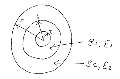

Three volumes bounded by three concentric spheres with radii a, b ​​and c. The innermost volume r<a, consists of vacuum. Next volume, a<r<b, is filled with a material having a constant volume charge density ρ1 and a relative dielectric constant ε1. The external volume, b<r<c, consists of a different material with ρ2 respective ε2. Outside the spheres, r> c, in vacuum.
Find E(r), V(r) for all r.
I.e. r<a, a<r<b, b<r<c, r>c

I have calculated the E(r) and V(r) for all r. However, I am not sure about certain E(r), especially E(r) for b<r<c and r>c which leads to my total E(r) and the calculations of V(r) of possibly being wrong. I am also not certain about certain V(r), especially V(r) for b<=r<=c and r<=a. Is my solution correct? Is E(r) and V(r) for all r correct?
Page 1: http://i.imgur.com/XckQoCM.jpg Equations used for calculation of E(r), Calculation of E(r)
Page 2: http://i.imgur.com/5ldfQHL.jpg Calculation of E(r)
Page 3: http://i.imgur.com/bn7ui8S.jpg Calculation of E(r), Total E(r) for all r.
Page 4: http://i.imgur.com/1SxJAP6.jpg Equation used for calculation of V(r), Calculation of V(r)
Page 5: http://i.imgur.com/RRCKCOb.jpg Calculation of V(r)
Page 6: http://i.imgur.com/Ihud14e.jpg Calculation of V(r), Final V(r).
Any help is appreciated.
Hi Sudharshan
On Page 2 while applying Gauss law to a spherical surface of radius r (b<r<c) and calculating Qfree , you have considered charge enclosed in the region b<r .What about charge in the region a<r<b ? Doesn't that come into account ?
Similarly on Page 3,for r>c , you have considered charge enclosed in the region b<r<c .What about charge in the region a<r<b ?
Hello Tanya,
These two parts you mentioned are the ones that I am not sure how to calculate. I do not know how to add the charge for region a<r<b for Page 2 and b<r<c for Page 3. Do I just multiply it in ? How do I proceed here?
I think you need to take algebraic sum of the two charges i.e ρ1V12V2 , where ρ is the density and V is the volume of respective regions.
In calculating the charge enclosed by the surface for finding D in the regions b< r< c and r>c, did you include the charge due to ρ1? [EDIT: Sorry, I see Tanya has already pointed this out.]
That looks almost correct. The only thing I see wrong is that you used incorrect dielectric constants for the regions b<r<c and r>c.
Oh yes. I see it now. Forgot to change the constant for b<r<c and remove it (since it is equal to 1 in a vacuum) for region r>c.

It appears to me that when integrating to find V, you still don't have all of the dielectric constants correct. For example, in region r > c, you still have an ##\varepsilon_1## appearing. In region b<r<c where you integrate from c to r, I see both ##\varepsilon_1## and ##\varepsilon_2## appearing.
Tanya Sharma said:
Hi Sudharshan
As stated by Tanya, I take the algebraic sum of the two charges i.e ρ1V12V2 when integrating to find E. Thus for r > c, I have ρ1V1 and p2V2 in the equation which leads to me having ε1 and ε2 in the final equation for E for r > c. This equation is what I use when integrating for V.
Here is my final E(r) for all r (after corrections):
http://i.imgur.com/a3jZ0Jg.jpg
Do you think my E(r) is wrong? If so, what am I doing wrong?
You first find D everywhere using Gauss' law. Just make sure that you include all the charge within the Gaussian surface. I think you have done that.
Once you have D in a certain region, then E is found from D using the dielectric constant for that region.
For example, the only dielectric constant that will appear in the electric field expression in the region b < r < c will be ##\varepsilon_2##.
Ahhhh. I understand now. I see my mistake. I have recalculated with the proper dielectric constants now I hope. Is my E(r) for all r correct now ?
http://i.imgur.com/bI87guV.jpg
Yes. That looks correct.
That all looks good to me.
Ok. Awesome. Thanks for all your help!
