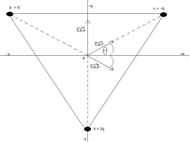

a) For a I made a force diagram similar to this:
I came up with: 412764 n/c x(hat) + 257978 n/c y(hat)
The angle I used for theta was 30* and the distance I came up with for r was .0132 m.

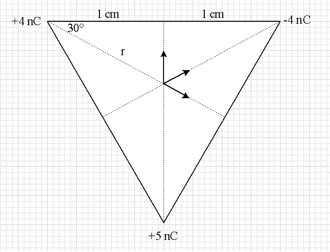

For (a) recheck your calculation for r. How did you determine it?
You'll want to redo (b) if you find a different value for r after checking.

Diagram 1 lists charges +4q, -4q, +5q ... but your diagram 2 lists +q, -q, and +2q .
If the side is supposed to be .020m, isn't the half-side 0.010m = r * cos 30 ?

I'm not sure what your charges are supposed to be, but a 2cm side would have a half-side being 1cm (so r is not 1cm)

Show your calculation for r. I'm finding a value that's just over 1 cm.
Since the value of r will affect every calculation in the problem, it's hard to comment on purely numerical results. You need to show your method to get feedback on whether what you're doing is correct or not.
So my method for finding r:
I split the equilateral triangle in half. That gives me a right triangle with a hyp of 2cm or .02m and an adj side of 1cm or .01m. I then used pyth. theorem like:
(.01)^2 +?^2 = (.02)^2 ==> ? = ((.02)^2 - (.01)^2)^(1/2) = .0173 m for the opp side. To find r I said r would be .0173/2 = .00865 which I rounded to .009.

Ah. Well there's a problem with that method. The distances from the vertices to that "center" would not all be the same. In fact, you'd find a different "center" for each vertex.
The center of an equilateral triangle is found by finding the intersection of the lines that bisect each vertex angle. That is, draw a line segment from each vertex to the center point of the side opposite. Where these lines intersect is the center:

Oh I see now okay so I come up with 1.155 cm or .012m if I round up. Is that correct?
Muuuuch better :)
