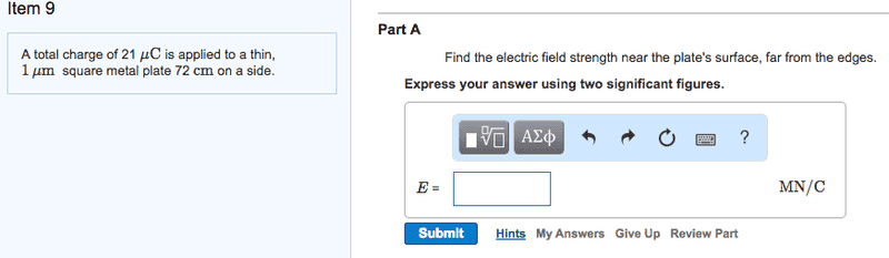

A total charge of 21 μC is applied to a thin, 1μm square metal plate 72 cm on a side.
Find the electric field strength near the plate's surface, far from the edges.
I think E = kq/r^2, but I really don't know.
I am having a hard time figuring out where to start. I know I must find the electric field strength (i.e magnitude), but where do I begin and what do I do to find it. I just know that E = kq1q1/r^2, but there is no second charge so it must be kq1/r^2 correct? Do I use that or something else?
No responses so far. Pressure's off if you've had your exam by now. Still want to address this one ?
There is a simple formula giving the E field near the surface of a charged medium such as a metal plate. Very simple.
My exam is today, but I managed to figure this one out. First converting the units into the proper units that I wanted to use I figured that for a plane its q/2a^2 and thus I entered to the units in and divided that by epsilon naught. I got 2.3 MN/C
Yes. My personal association is with the term Gaussian pillbox
A comment on the exercise: I miss the words 'uniformly distributed' ; that way good students easily get wrong-footed.
