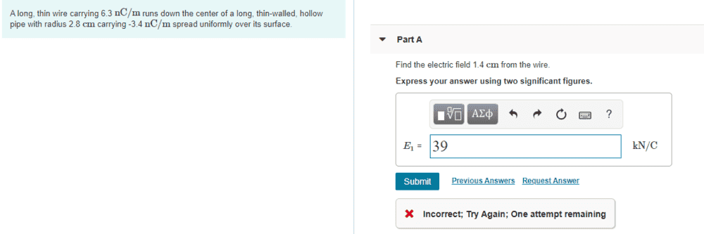

Hello, this is my first post on the physics forums. Please forgive me if I am not following any post structure well. The question is supposed to use Gauss's Law, but I cannot understand how it would apply to a cylinder that you cannot obtain the surface area of (we are not given L), let alone an object that is not closed. How do you go about this?
(Difficult to write without access to integral and vector symbols.) I am using Gauss's Law and General superposition of an electric field.
I have no idea how to approach the problem using Gauss's Law.
I found the electric field using superposition, and it was incorrect.
I am assuming you treat the wire as a continuous electric field, and then also treat the pipe as a continuous electric field. I solved for this using superposition, but it was incorrect, so then I tried multiplying it by 2πr (circumference) and it was incorrect as well. Maybe I input the wrong values? Any help is appreciated. Thank you.

Thank you for the welcome. Say I created a Gaussian cylinder with a radius of 1.4 cm, centered at the infinite wire, with a finite length of 10 cm. Would this provide me with the answer I am seeking? Or, would I then superposition that field value with the given charge of the outer cylinder?

I imposed my own Gaussian surface using a cylinder centered at the wire with a radius of 1.2 cm. I used the formula Φ = qenclosed0. I ended up with an electric field of 711.86 N/C. To clarify, should I superposition this value with the outer tube's electric field? Or, when the question is asking for the field, do you think it does not include the outer value? I am unsure of how to go about using superposition here.
At this point I want to clarify that obtaining the Gaussian surface is not where I am struggling- rather, it is what to do with said Gaussian surface whenever there is another, oddly shaped electric field acting upon it. How do I generate a net field from that? I have attached a rudimentary drawing to explain my dilemma. The outer sphere is a positively charged sphere of negligible diameter. Could someone elaborate on this conceptually for me? I'm sorry if I am not being descriptive enough. I am having trouble expressing my issue.

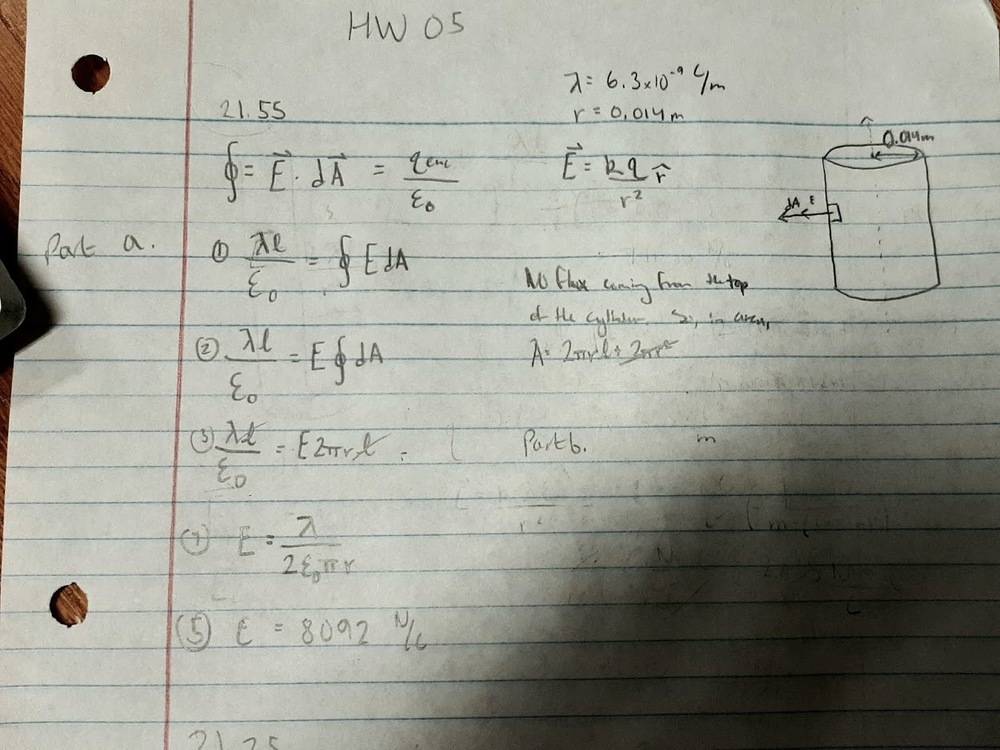

Generally speaking, Gauss's Law only applies to the total charge within the closed, Gaussian surface. Any charge outside the closed, Gaussian surface doesn't affect the end result. That idea is the crux of Gauss's Law.

That's the linear charge density. It means that every meter of wire contains [itex] 6.3 \times 10^{-9} [/itex] Coulombs of charge. Typically, this is denoted by the variable "lambda", [itex] \lambda [/itex]. So here, [itex] \lambda = 6.3 \ \mathrm{\frac{nC}{m}} [/itex].
If you have strip of wire of length [itex] \ell [/itex] with a linear charge density of [itex] \lambda [/itex], then the total charge on the wire is [itex] q = \lambda \ell [/itex].
Now apply that to this problem. If you have a Gaussian surface of length [itex] \ell [/itex] surrounding a wire with linear charge density [itex] \lambda [/itex] (and nothing else inside the surface), then what is the total charge enclosed within the Gaussian surface?

No, [the field] from the outer pipe doesn't. That's because if a particular charge is outside the Gaussian surface then every field line originating from that charge that enters the surface must also exit the surface. All field lines originating outside the surface have an equal number of exit and entry points, which ultimately cancel. Only field lines that originate [or terminate] from inside the surface don't [necessarily] cancel. :smile:

Thank you for the help. I finally got the problem! Well.. at least part A. I know from personal experience that it would be best for me to post my work after I got the answer, so here I have it attached:
Likes Delta2 and collinsmark
'Looks good to me. Good job! :smile:
