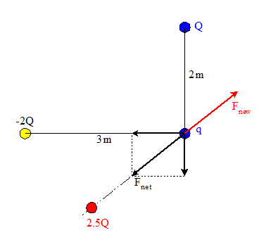

Summary:: I try to find the resultant force on "q". I think I have to find the value of Q, but I'm not sure.
I Know F1 = k|q * 2Q| / 3² and F2 = k|q * Q| / 2²
Hi,
this is my first post on this forum I hope I posted in the right section.
I Know F1 = k|q * 2Q| / 3² and F2 = k|q * Q| / 2² However, I'm stuck. Here is a image.
That's pretty much all I can find right now.

I forgot to mention. The answer should be kqQ(-0,222i -0,250j)
Yup. Notice the variables q and Q and the constant k in the result.
Actually those numerical values don't look right to me, given the distance values shown in your image. How have you defined your coordinate axes?

I have another question about the same problem.
Basically, I have a 2.5Q charge and I need to find where to place it to have a null resultant force on q.
I know the charge should be between Q and -2Q. So the charge should be -x -y.
I know that -(k|q x 2Q| / -3²) - (k|q x Q| / -2²) + Fe = 0
Then, to find the x distance I write -0.222 + 2.5/d cos theta = 0
Is it good?
A simple approach would be to make a sketch first. Pencil in your net force vector from the first problem. Where would you place a new charge to exactly counteract that force?
I guess it will be there :
I'm thinking of using something like -0.222 +Fe cos theta = 0.
I mean I tried a lot of thing, but I can't find the solution. I miss something, but I don't know what.
In order to exactly counteract the net force from the other charges, it will have to be placed along the same line as the net force from before, right?
So first find the distance from q that the new charge will produce the required magnitude of force. Then find a way to place it on the line segment that extends in the Fnet direction.

No. Think about scaling the position vector associated with the Fnet.
You want to make the magnitude of the force due to the new charge that will cancel the net force due to the other charges. Take a look at the magnitude of the current net force. So the magnitude is ##F_{net}=k\frac{Q q}{3^2 +2^2}## where the items in the denominator are taken to have the units meters.
The new charge being introduced has a value of ##\frac{5}{2}Q## (5/2 is 2.5, right?). So at what distance from q will it produce the same magnitude of force as the current net force? At this point you are not concerned about the charge location, only the distance.
##k\frac{\frac{5}{2}Q q}{d^2} = k\frac{Q q}{3^2 + 2^2}##
Solve for d. That's the length of the vector to the new charge location (from q's position) along the projection of the ##F_{net}## vector.
I trust that you remember how to scale a given vector by multiplying it by a constant value.
In this case d = 5.7m and this is the distance from q to the new charge, right? Which is what I'm looking for.
However, the answer in my book is x = -1.82 y = -2.04.

The ##\frac {kQp} {3² + 2²} ## term is not correct. The 3 and 2 came from the placement of the the original charges.
You've already solved for the ##F_{net}## vector : kqQ(-0,222i -0,250j). What's the magnitude of this vector?
Likes Babybluedino
Alright.
0.222² + 0.250² = 0.334 which is the resultant force of the first 2 charges.
Then 0.334 - F3 = 0 → 0.334 = 2.5 / d² → d = 2.73
0.334 cos Θ = 0.222 → Θ = 48.3°
2.73 cos 48.3 = 1.82m
2.73 sin 48.3 = 2.04m
Looks much better!
