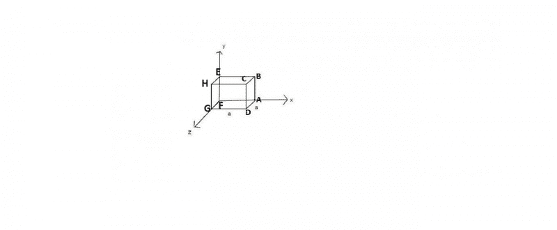

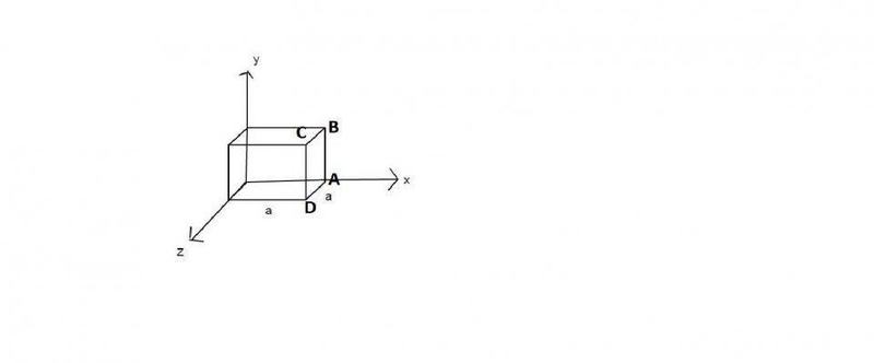

the electric field components in the figure below are Ex=800 x^2 N/C ,Ey=Ez=0 calculate the flux through the cube
a=assume 0.1 m
here flux of cube =flux through ABCD
=800a^2 i^.a^2 i^
=800a^4
=800 × (0.1)^4
=8×10^2 ×10^-4
=8 ×10^-2 Nm^2/C

That's just a dot product between the E field on the ABCD plane, ##800a^2 \hat{i}##, and the area vector of this plane, ##a^2 \hat{i}##,
800a^2 \hat{i} \cdot a^2 \hat{i} = 800a^4 (\hat{i} \cdot \hat{i}) = 800a^4
with ##\hat{i} \cdot \hat{i}=1##.

If I were to write the more complete expression of the total flux going through the cube, it will be
\oint \mathbf{E} \cdot d\mathbf{a} = \int_1 \mathbf{E_1} \cdot d\mathbf{a}_1 + \int_2 \mathbf{E}_2 \cdot d\mathbf{a}_2 + \ldots + \int_6 \mathbf{E}_6 \cdot d\mathbf{a}_6
where the integrals on the RHS account for the six surfaces of the cube. However since the E field is along the x direction, only two of those six integrals will survive upon the dot product with the area vector. Let's suppose that the surfaces ABCD and EFGH are the first and second integrals above, respectively. Then it becomes
\oint \mathbf{E} \cdot d\mathbf{a} = E(ABCD) a^2 - E(EFGH) a^2
What is the electric field in the EFGH plane?

That's why you have to calculate it. The field has the form of ##E_x = 800x^2##, now what is ##x## equal to for the EFGH plane?

blue_leaf77 said:
now what is xx equal to for the EFGH plane?
it's zero.So E=0 for EFGH plane.And therefore
flux of cube =flux through ABCD.Right?
Right.
