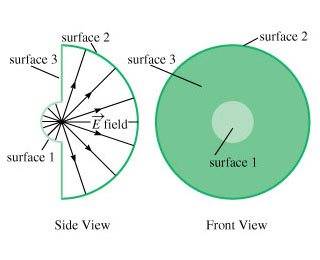

In summary, two hemispherical surfaces, 1 and 2, of respective radii r1 and r2, are centered at a point charge and are facing each other to form an annular ring (surface 3). The electric field at position r⃗ due to the point charge is given by E⃗ (r⃗ )=C/r^2 r_hat, where C is a constant proportional to the charge, r=∣∣r⃗ ∣∣, and r_hat=r⃗ /r is the unit vector in the radial direction. The angle between the area vector and electric field vector is 90 degrees, leading to 0 electrical flux through surface
Inveritatem
Two hemispherical surfaces, 1 and 2, of respective radii r1 and r2, are centered at a point charge and are facing each other so that their edges define an annular ring (surface 3), as shown.
The field at position r⃗ due to the point charge is:
The hints imply that because the electric field lines everywhere are parallel to the annular ring (surface 3), the angle between the area and electric field vector is 90, which implies that the flux through surface 3 is 0. I am confused as to why this is the case, as looking at the picture I only see one possibility:
From the side view, the electric field lines seem to only go through surface 1, meaning no electric field passes the surface of surface 3, which leads to 0 electrical flux.
Can anyone help explain why there are electrical field lines that form a 90 degree angle with the area vector?
Be sure you understand the convention for the direction of an area vector.
In the side view picture, pick any point on surface 3 and draw the area vector for a small patch of area at that point. Also draw the direction of the field at that point.
EDIT: I think the confusion is with the wording of the hint. It should have said the the angle between the area vector and the electric field vector is 90o.
