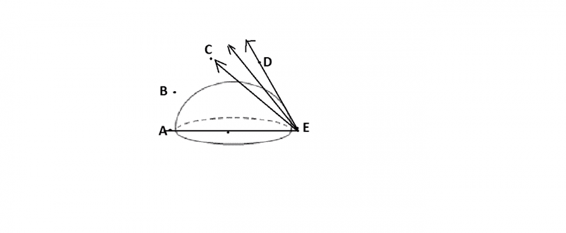

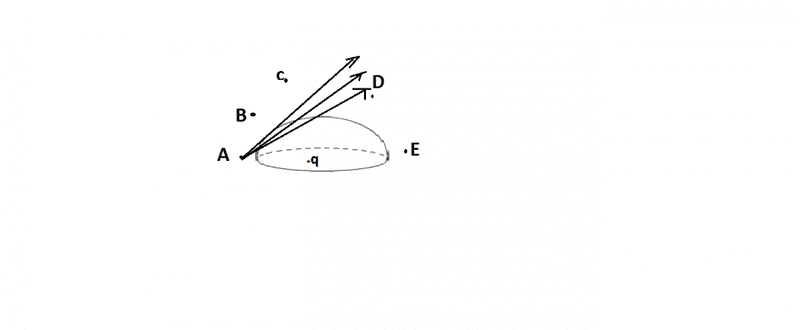

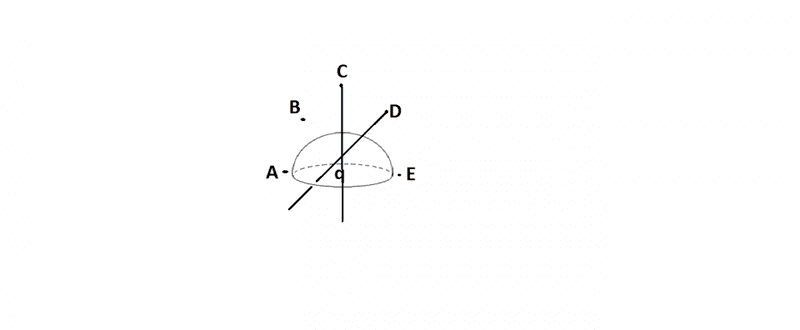

The figure shows a charge q placed at the centre of a hemisphere. A second charge Q is placed at one of the positions A,B,C and D .in which position(s) of this second charge , the flux of the electric field through the hemisphere remains unchanged ?
2. Relevant Point:
My textbook says "if the vector E line from a charge cuts the surface once -there will be net contribution to the electric flux."
In the following cases
Obviously from points A and E all the straight lines cut the surface twice as shown below.So if we happen to bring another charge Q at any of these two points the value of electric flux would not change because these will not contribute in it.But what about other points B,C & D?I am unable to figure out for these points.How to sketch the diagrams for these points?Any help would be greatly appreciated!

are you sure it says that? Seems exactly wrong to me. If the line passes through the surface an even number of times then there should be no net contribution, surely?
haruspex said:
surely?
Yes
my book mentions about the case when the line touches the surface twice.
Touches or passes through? If it touches without passing through, any number of times, that makes no contribution. Each pair of times it passes through there's no net contribution (two passes in opposite directions cancel), so any even number of passes also makes no net contribution. But for the present problem, it is just the two passes case that matters.

If the electric line from a charge Q cuts the surface once-it will make net contribution to the electric flux.
And then it has been written That electric field lines emerging straight from charge Q WHEN it is kept at points at points A and E cut the hemisphere twice hence do not contribute in net electric flux.

Gracy, please could you edit your first post in this thread and make corrections to its problem statement.
There may be some confusion in the use here of "E" to simultaneously denote the general electric field vector and also a reference point.
Your hemisphere has a curved upper surface and a flat lower surface. There is no way that field lines from any external charge can enter the hemisphere without also exiting through a surface, therefore these contribute no net flux. Only the enclosed charges can contribute flux.
EDIT. Perhaps your textbook wants you to consider only the curved surface? If you look at it that way, where there exists only the curved surface "shell", then the question makes more sense.

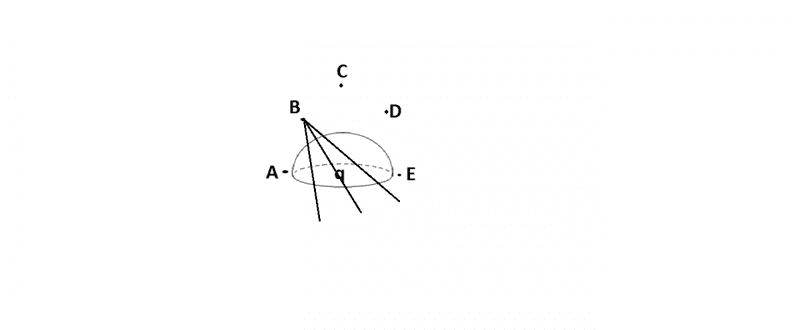

So from point B, draw lots of lines radiating outwards in all directions. Those that completely miss the hemispherical shell obviously contribute nothing to the flux through it. But what observations can you make about those field lines that don't completely miss the shell?
P.S. Your textbook is correct.
I have drawn for Points A and E,I want help to draw the diagrams for other points B,C &D
See advice in post #21

I suspect that's the intended interpretation of "hemisphere" here. Too bad they didn't make that clear in the problem statement.

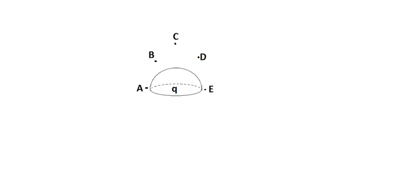

The figure shows a charge q placed at the centre of a hemisphere. A second charge Q is placed at one of the positions A,B,C and D .in which position(s) of this second charge , the flux of the electric field through the hemispherical curved surface remains unchanged ?
2. Relevant Point:

The point of adding that was to make it clear that it is not a closed hemisphere, i.e. the surface does not include a flat base.
Btw, I owe you an apology for confusing you. I consistently misread the text you quoted as saying that if it cuts the surface once there is NO net charge. Sorry for the noise.

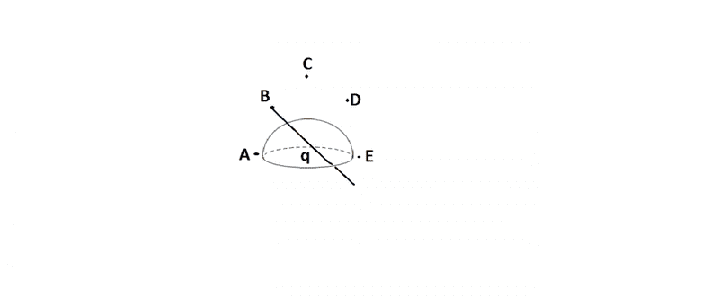

When I draw for point B ,The line emerging from it also cuts the surface twice
  • #33
It is not possible to deduce from that drawing whether it cuts once or twice.
I interpret the diagram as meaning that the five points lie in a vertical plane bisecting the hemisphere. Consider looking at the hemisphere from point B. Some lines from there might cut the hemisphere twice, but if there are any lines that cut it only once then there will be net flux.

To cut means to pass through ,how to count how many times it (surface)gets cut?
  • #35
Imagine the hemisphere as made of tinted glass. If you were to look from point B, what would it look like? Are there parts where you would only be looking through one glass surface?
