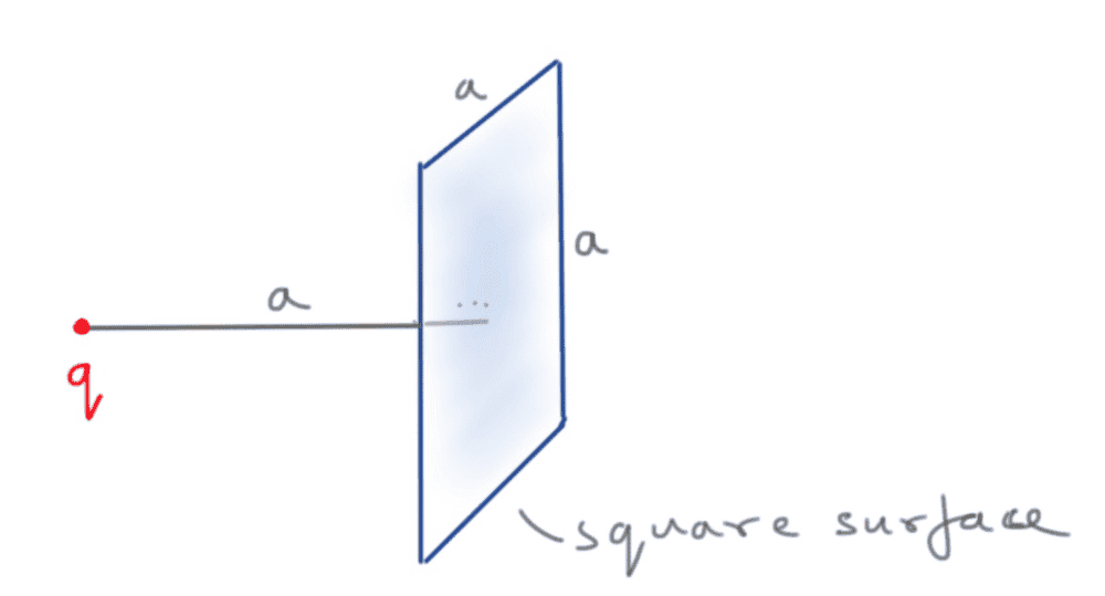

find the electric flux through a square sheet of side length ##a## due to a charge ##q## placed a distance ##a## away from the centre of the square.
##\phi = \int \vec E.\vec{da}##
taking origin at the centre of the square.
##d\phi = \vec E.\vec{da}##
$$d\phi = \frac {kqa}{(x^2 + y^2 + a^2)^{3/2}} da$$
$$\phi = \int_{-a/2}^{a/2}\int_{-a/2}^{a/2}\frac{kqa}{(x^2+y^2+a^2)^{3/2}}(dx)(dy)$$
on evaluating this double integral i get $$\phi = (q/\pi{\varepsilon}_0 )(tan^{-1}(\frac{1}{2\sqrt{6}}))$$
