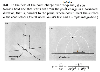

Right. I still remember a problem from Purcell's text from my student days 50 years ago. It required setting up a Gaussian surface that passed through a point charge. I recall feeling uncomfortable at the time with dealing with this. Your approach would have helped! If you're interested, here is the problem:
Purcell had already worked out the induced charge density, σ, on the plane earlier in the text.
Interesting problem, I shall give it a go when I get up to conductors : ~ )
