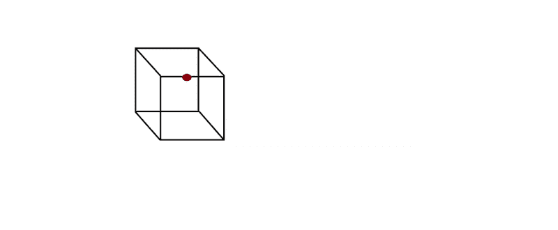

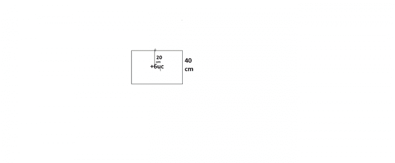

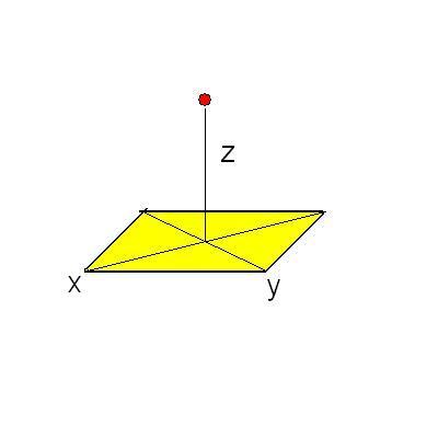

A point charge of +6μC is placed at a distance 20 cm directly above the center of a square of side 40cm.The magnitude of the flux through the square is
Now how to enclose the charge completely?The answer is with the help of 5 more squares but I want to know how?Because this will make a cube
The charge is not enclosed completely.
Think in 3D.
Likes gracy
Understood.Thanks @ehild.
