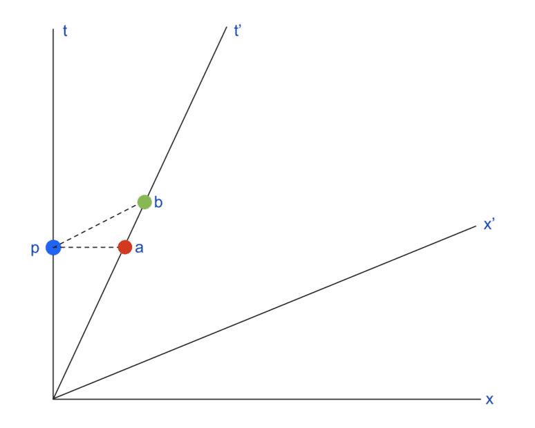

Thought it might be useful to illustrate @TSny's nice idea,
The event ##p## is the measurement of ##E## by the unprimed observer.
In the unprimed frame, ##p## is simultaneous with the point ##a## on the charge's worldline.
In the primed frame, ##p## is simultaneous with the point ##b## on the charge's worldline.
Then, in terms of the quantities that @TSny has defined, you have ##x = x(a) - x(p) = x(a)## whilst ##x' = x'(b) - x'(p) = -x'(p)##.
Likes TSny
