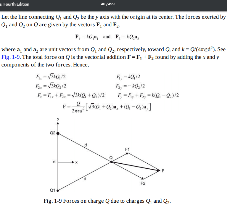

Three point charges Q, Q1, and Q2 are separated by a distance d from each other in a homogeneous medium. Find the electric force on Q.
Pythagorean theorem
x^2 + d^2/4 = d^2
x = sqrt(3d^2/4)
F_1x = sqrt(3)*d*k*Q1/2.
In the solution, where did the "d" in the numerator go??
Is my math wrong?
I cannot make sense of that equation. I think you have some typos, and an unclear notation.
Is that ##F_1x## or ##F_{1x}## on the left?
Why are you multiplying by d instead of dividing by d2?
adamaero said:
x^2 + d^2/4 = d^2
x = sqrt(3d^2/4)
Why are you calculating the distance "x"?
"F" sub "1x" the exact same in the solution except without the "d".
d2 is in the term "k".

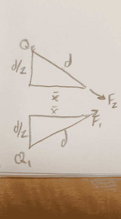

I thought that is for the direction of the vector defined by a1 (in F1 = k*Q1*a2).

Hmm... yes I see that is how they have used k in the solution too, but it is very nonstandard. The usual is ##k=\frac 1{4\pi\epsilon_0}##.
A component is obtained by multiplying by the cosine of the angle. You need to divide by the hypotenuse.
That makes sense where the "d"s cancel out...but I don't understand why the Pythagorean theorem can't be used alone.
cos(θ) = (d/2)/d
cos(θ) = 1/2
So it's the magnitude of "x"combined with the direction (defined by the cosine-term), and that's just what makes a vector...and not a scalar?
No, it's the magnitude of the force multiplied by the cosine. The only relevance of the magnitude of x is in finding the value of the cosine, as x/d (which is √3/2, not 1/2).
