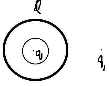

A metallic spherical shell contains a charge Q on it. A point charge q is placed at the centre of the shell and another charge ##q_1## is placed outside. All the three charges are positive the force on the charge at the centre is ..... and the force on the central charge due to the shell is.....
Electric field inside a conducting shell due to the shell or outside charge is zero.
Hence the electric force on the charge in both cases is zero. Is this correct?

The Gaussian surface is concentric spherical and drawn in the picture.
I edited my last post #3 after your post #4.
The picture also shows charge ##q## enclosed by the Gaussian surface. Is that the case or is that not the case? If there is no charge inside the shell and you think that the electric field inside the shell is not zero, then draw an electric field line that you think might be appropriate inside the shell. Be mindful of the fact that electric field lines start at positive charges and end at negative charges, i.e. they point from a region of high electric potential to a region of low electric potential.

The charge q is there at the center. For calculating electric field due to charge Q on the shell and ## q_1## outside inside the shell, I have taken no charge at the center.
The net electric field inside the shell is 0, but electric field due to the shell's charge Q and outside charge ## q1## separately are non-zero.
That is what I meant in #3.

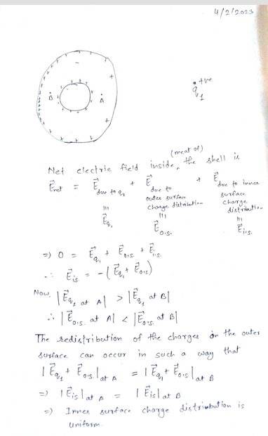

According to 1) and 2) in post#16, the tangential component of the net electric field at the conducting surface is 0 and it has only non-zero perpendicular component of net electric field. Hence, the net electric field has to be perpendicular to the shell's surface i.e radial. Since, Q and ##q_1## are positive, the electric field originates from them towards the shell. Hence, it is radially inward.
The electric field inside the shell is not due to Q and ## q_1##.
The charges distributes themselves in such a way that there is no electric field inside the meat of the shell. To cancel the electric field due to ##q_1## and positive charge on the outer surface, some positive charged particles get distributed on the inner surface.
The electric field is due to the positive charges present on the inner surface of the shell. The inner surface is equipotential. Hence, the electric field is perpendicular to the surface and away from the surface i.e. towards radially inward direction.
Since, I do not know the magnitude of the net electric field, hence I draw them as non-constant. The electric field near the surface is considered to be higher as it is closed to the positive charge there and according to Coulomb's law, electric field is inversely prorportional to ##r^2##.

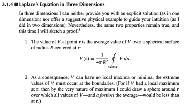

The above images have been taken from Griffith's Introduction to Electrodynamics.
Considering the highlighted part, the non-uniform charge distribution occurs only at the outer surface. The charge distribution at the inner surface is uniform. This distribution rersults into net electric field being 0 in the meat of the shell as well as inside the shell.

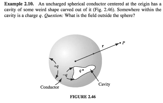

Under the effect of ##q_1## the redistribution of charge Q takes such that it is non-uniform on the outer surface and uniform on the inner surface. This distribution results into net electric field being 0 in the meat of the shell as well as inside the shell.
The above image is taken from Griffith's Introduction to Electrodynamics.
Taking ##\vec r## as the center of the shell and the inner surface of shell as the surface for integration, potential at center equals potential at the surface from 1st property.
From second property, there can be no local maxima or minima, implying V being constant in the volume covered by the inner surface. Hence, in this region ## \vec E_{net} = -\nabla V = 0##.

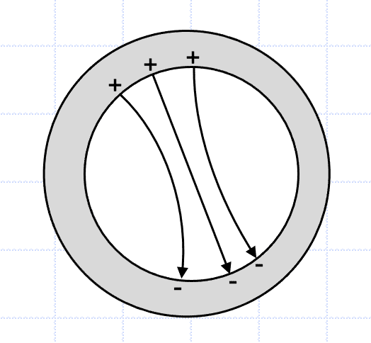

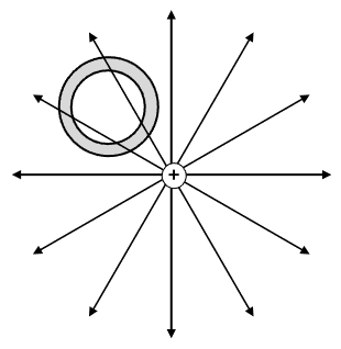

I introduced the dielectric shell with cavity in the presence of an external charge as a counterexample to convince the OP that Gauss's law is not the way to go if one wishes to show that the electric field in the cavity of the conductor is zero. The Gauss's law argument (whatever that is) that OP uses to show that field inside the conductor cavity is zero (where it is actually zero or so I thought OP thought) should be applicable to show that the field inside the dielectric cavity where we know that the electric field is not zero. How can the same Gauss's law argument produce different results depending on the shell material? I tried to get the OP to see that Gauss's law is not the basis for why the electric field inside the conductor cavity is zero. I now see that OP needs to understand what Gauss's says before proceeding any further.
I hope this helps you find your way through this morass of posts and textbook references and zero in what OP understands and what OP does not understand. My next step is to show how the picture in #20 violates Gauss's law.
Likes Pushoam
kuruman said:
That is why I asked the OP to sketch and post the field inside the cavity which was done in post #20. OP seems not to understand that this sketch violates Gauss's law which should be the first order of business because OP seems not to understand what Gauss's law is saying.
I am sorry.
That field which I drew in post#20 is wrong as that indicates presence of negative charge in the cavity.
Likes kuruman
Pushoam said:
I am sorry.
I'm glad you realized that because it saved me some work. So is there an electric field inside the conducting shell when there charge ##Q## on the shell, charge ##q_1## outside the shell and no charge inside the shell? If "yes", please post a revised drawing of the cavity with the field inside that satisfies Gauss's law. If "no", explain why not.

Pushoam said:
Electric field at the surface of a conductor is perpendicular to its surface as any tangential component gets cancelled by the movement of chargedparticles. Hence, electric field at the inner surface of the shell is radially inward (and the presence of charge q at center doesn't affect this direction). Hence, from (1), ## \vec E_{shell} +\vec E_{outside~ charge}= 0 ## inside the shell.
The above conclusion is wrong.
The electric field inside the shell and on its inner surface can neither be radially inward nor in any other direction. Hence, it has to be 0.

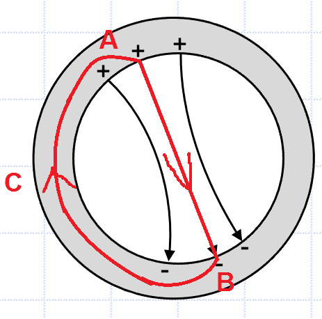

You need to be more specific here. Suppose that the charges on the inside surface of the cavity redistribute themselves due to the external charges ##Q## and ##q_1## so that there are field lines inside the cavity but not inside the meat of the conductor (see schematic below.) One could argue that the field inside the meat of the conductor is zero as it should. Also, this arrangement satisfies Gauss's law. If I draw a Gaussian surface inside the meat of the conductor, the net flux through the surface is zero and so is the net enclosed charge. The same is true if I draw a Gaussian surface inside the cavity because all the field lines that enter the surface leave it and there is no enclosed charge. So what is the argument that says that the picture as shown below cannot be the case? Try to be as specific as you can.
Likes Pushoam
The above charge distribution doesn't guarantee 0 electric field inside the meat of the shell.
The inner surface of a conducting shell has to be equipotential.
In the given diagram, potential near the negative charge is not equal to the potential near the positive charge. Besides this charge distribution also creates a component of electric field along the inner surface. The charges will move on the inner surface to make it equipotential and 0 electric field.
Just because the diagram satisfies the Gauss's law doesn't mean that electric field inside the meat is 0.
To cancel the field due to ##q_1## in the meat of the shell, a part of charge Q distributes on the upper surface and rest of Q on the inner surface. So, the negative charge can not stay there on its own. It gets neutralised due to the presence of other positive charge.
  • #31
Using ## \oint \vec E \cdot d \vec l =0 ## for the closed loop ABCA shown in the figure, where the part AB inside the cavity is along the direction of electric field, to calculate the magnitude of ## \vec E## inside the cavity, $$\oint \vec E \cdot d \vec l =0 $$$$ \int_A^B \vec E \cdot d \vec l + {\int_B^A }_{through~ C} \vec E \cdot d \vec l = 0$$$$ \int_A^B \vec E \cdot d \vec l = -{\int_B^A }_{~ through~ C} \vec E \cdot d \vec l $$
Now, ## {\int_B^A }_{through~ C} \vec E \cdot d \vec l = 0## as electric field inside the meat of conducting shell is 0.
Hence, $$ \int_A^B \vec E \cdot d \vec l = -{\int_B^A }_{through~ C} \vec E \cdot d \vec l = 0 ... (1)$$ As the part AB inside the cavity is along the direction of electric field, $$ \int_A^B \vec E \cdot d \vec l =\int_A^B E dl =0 $$$$\Rightarrow E = 0 \Rightarrow \vec E = \vec 0 $$
Hence, the above calculation and precisely, ## \oint \vec E \cdot d \vec l =0## says that there can be no electric field inside the shell.
Likes kuruman
  • #32
Yes, that is the argument. Simply put without line integrals, electric field lines point from high to low electric potential. If there were an electric field line in the cavity from point A to point B, that would mean that point A is at higher potential than B. This contradicts the fact that all points on the conductor are at the same potential.
Likes Pushoam
  • #33
Thanks for guiding me.
Likes kuruman
