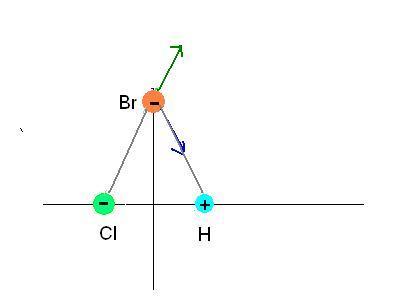

I might be overthinking this problem. I was thinking that the bromide ion be in the positive x-direction to attract it to the partial positive negative ion. I'm confused about how the y-direction might come into play in this problem. I was also thinking that these charges might cancel out because they are directly opposite of each other on the x-axis.

Make a drawing showing the position of the atoms, and draw arrows showing the magnitude and direction of the forces.

See the picture. As the HCl molecule is neutral, the positive charge on the hydrogen is equal in magnitude to that of the negative charge on the chlorine. As they are at equal distances from the bromine atom, both the hydrogen and the chlorine atom exert equal forces on the bromine, but the force of the hydrogen is attractive, that of the chlorine is repulsive. See the picture.
What is the direction of the resultant force on the bromine?
Read the problem carefully. All questions refer to the force applied on the bromine atom.
