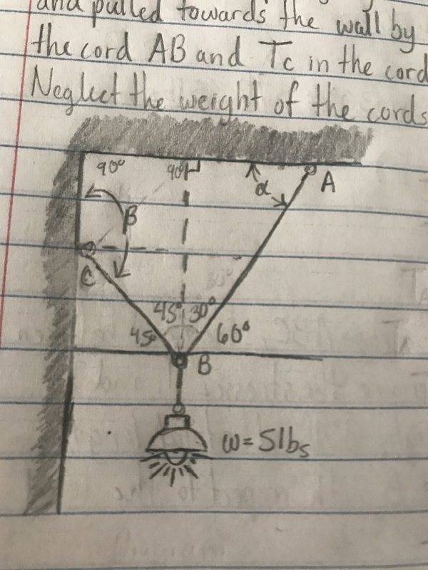

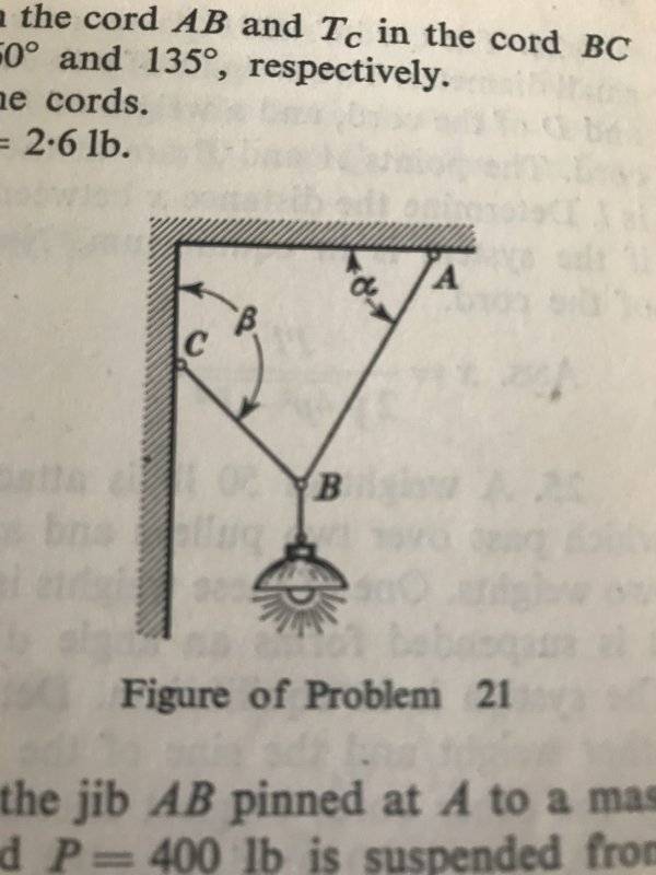

An electric lamp weighing 5lbs is suspended by a cord AB from the ceiling and pulled towards the wall by the cord BC. Determine the tensions ##T_{A}## in the cord AB and ##T_{C}## in the cord BC if the angles ##\alpha## and ##\beta## are ##60^{\circ}## and ##135^{\circ}##, respectively. Neglect the weight of the cords.
Ans. ##T_{A}##= 3.65 lbs ##T_{C}##==2.6 lbs
$$\sum \vec{F}=m\vec{a}$$
I had made equations for the forces in the x-direction and y-direction, but when solving them they yielded the wrong answers, which makes me think that they were incorrect:##(T_{A}cos60^{\circ}+T_{C}cos45^{\circ})=0##
##(T_{A}sin60^{\circ}+T_{C}sin45^{\circ})=5lbs##
Here's the diagram for the problem:

Can't see where you go wrong if you don't post your work.
Question: in $$T_{A}\cos60^{\circ}+T_{C}\cos45^{\circ}= 0$$ I see four things that are positive. How can that give 0 ?
Likes cwill53
cwill53 said:
##(T_{A}cos60^{\circ}+T_{C}cos45^{\circ})\hat{x}=0##
##(T_{A}sin60^{\circ}+T_{C}sin45^{\circ})\hat{y}=5lbs##
Best not to write that; you've got vectors on the LHS and scalars on the RHS. Also, as @BvU pointed out, the first equation should be setting off alarm bells!
Look at your first equation. You know that ##\sum F_x = ma_x = 0## here. What is the ##x## component of the force exerted by the member BC?
Likes cwill53
I don't see any other forces in the x-direction.
Should it be ##(T_{A}cos60^{\circ}-T_{C}cos45^{\circ})=0##?
Likes BvU
If I pull to the left and you pull to the right, and we pull with equal forces, will something in the middle accelerate twice as fast as when I pull alone ? Or will it stay in place ?
Nice drawing, but physics sketches should be restricted to the bare essentials
Yees. Why ?
BvU said:
Yees. Why ?
Because that's the only way that makes sense if the system isn't accelerating. You can't add two positive numbers and get 0.
cwill53 said:
Should it be ##(T_{A}cos60^{\circ}-T_{C}cos45^{\circ})\hat{x}=0##?
Pretty much, but it should be either
##(T_{A}cos60^{\circ}-T_{C}cos45^{\circ})\hat{x}=\vec{0}##
or
##T_{A}cos60^{\circ}-T_{C}cos45^{\circ} = 0##.
As for the trouble with signs, ##\vec{T}_C = \vec{T}_{Cx} + \vec{T}_{Cy} = T_{Cx} \hat{x} + T_{Cy} \hat{y}##. If you draw the component vectors in the ##x## and ##y## directions, you know that ##\vec{T}_{Cx} = T_{Cx} \hat{x}## has to point to the left (i.e. in the ##-\hat{x}## direction). This should give you some clues as to the required sign of ##T_{Cx}##...
Likes cwill53
It will stay in place because the forces will cancel out.
I like to draw the pictures for reference in the future; this book is long out of print.
Likes BvU
I mean it seems you've got the knack for it... just make sure not to spend too long on the shading...
It might also help to draw the unit vectors you're using on the diagram as well. Just so that when you see the force is acting in the negative ##x## direction, you can go 'aha', the coefficient of ##\hat{x}## has to be negative so ##F_x < 0##.
Likes BvU and cwill53
Thanks, I'll do that from now on.
@BvU @etotheipi Thanks for the help, that fix did the trick.
