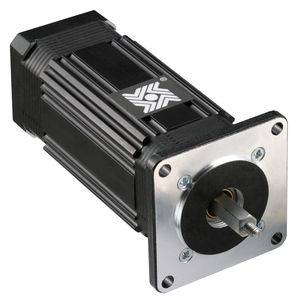

Perhaps something like this http://www.directindustry.com/prod/haydon-kerk-motion-solutions/electric-actuators-rotary-linear-31460-176422.html?
This is an Electric linear rotary actuator manufactured by Haydon Kerk Motion Solutions which is designed for independent linear and rotary motion from a compact package.
Well, that doesn't look like what I'm after. From what I can google, it looks like linear actuator is the name for a whole range of linear motors, most of them driven by screws. Also, the broken English on that product's description doesn't reveal very much about how it operates :) However, following a few links I discovered the term "direct drive linear motor" which is essentially what I've described above. Most of them are servomotors, which is more complex than what I'm after. Maybe I can modify one.
