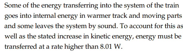

For part (b),
The solution is,
However, if the acceleration was not constant during the 21 ms, then would the power required be larger?
I believe the average power required would be larger because if the train started off at a lower speed and then speed up very rapidly towards the end reaching the same speed, a very large force would have to be applied.

However, if the acceleration was not constant during the 21 ms, then would the power required to reach the same speed be larger?

Can you show how the back-of-book solution got the answer ?
After that, explain how you think that power equation relates to the information given in the problem.

Thank you @hmmm27 ! Here it is,
They just used the work energy theorem to find the average power.
The question as posed can be answered as "zero". What they should have asked for is the minimum value of the average power. Since ##P_{avg}=\frac{\Delta E}{\Delta t}##, it does not then matter how the power and acceleration vary over the interval.
So why might the average power be a bit more ?
Likes member 731016, hutchphd and erobz

How can it be answered as zero?
I think average power could be a bit more due to not all the work going into kinetic energy due to non-conservative forces acting.
Because it could have been no power for some of the time and lots at other times.
As has been noted, the average power does not depend on the pattern of acceleration, only on the speed reached and the time taken. But for minimum peak power, as @hutchphd notes, you certainly do not want constant acceleration. Because P=Fv=mav, as it gains speed you need more power for the same acceleration.

If finial KE = inital KE?, how would that be possible?
No, initial and final KE as before, but all the work being done in less than the allowed time.
Do nothing for 1ms, then go from rest to 0.620m/s in 20ms.
Callumnc1 said:
what is minimum peak power?
If the maximum power the engine produces during the acceleration is ##P_{peak}##, what is the minimum possible value of that to achieve the given speed in the given time?

No, nothing so advanced. If the peak power available is ##P_{peak}## then the most energy you can get out of it in time t is ##P_{peak}t##, and you can only get that by operating constantly at that power. So for a given KE achieved, the minimum ##P_{peak}## is ##E_K/t##.

Ahh, so "peak power" is a bit misleading. It's actually just constant power which gives you this. Thanks!
