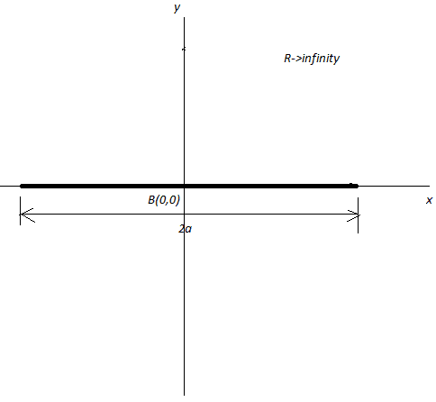

Find potential of a uniformly charged rod of length 2a
-Superposition
[tex]dV=\frac{kλdx}{r}, r=x[/tex]
[tex]V=λk\int\limits_{-a}^a \frac{1}{x}\mathrm dx=0[/tex]
Potential at point B is zero. Is this correct?
No. Your integral doesn't exist. But even before, what is it you are integrating, and over what are you integrating ?
As a check: it is likely that V = 0 at infinity, so it can't be 0 at pont B.
