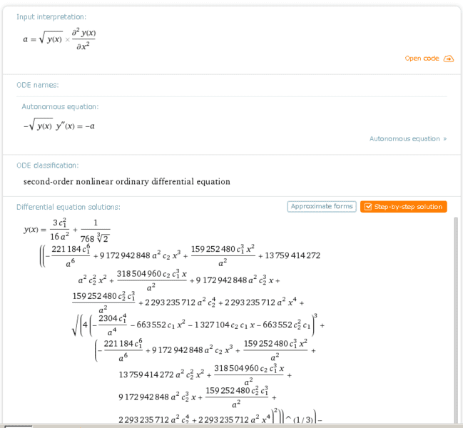

Here's what I had done:
- Apply Gauss's laws for a tiny box region, with surface S, thickness dx, we end up with this equation: $$ρ=ε*\frac {dEe} {dx} (1)$$ in which ρ is the charge density, Ee is the electric field created by the charge (the field created by the voltage U is Ep, the total field is E).
- The current flowing inside this diode must be a constant everywhere inside the diode, regardless of position x. According to the definition of current: $$I=\frac {dq} {dt}=ρSv$$ in which v is the velocity of the electron at position x. Take the differentiation of I we get: $$0=v\frac {dρ} {dx}+ρ\frac {dv} {dx}$$
- The Second Newton laws of motion for one electron is $$e*E=m\frac {dv} {dt}=mv\frac {dv} {dx}$$
- Use substitution, we get the following equation: $$\frac {dρ} {ρ^3}=\frac {eS^2} {mI^2}Edx$$, integrate it, and we get $$-\frac {1} {ρ^2}=\frac {2eS^2} {mI^2}V+C$$ and now I'm unsure what to do, maybe we shall set C=0 and use equation (1) then we will end up with $$ω\sqrt \frac {U} {V} =ε\frac {\partial^2 V} {\partial x^2} $$ ω is the electron density at the anode. Solve this don't works as the solution is very complex.
I think you are essentially OK up to here, except I don't believe you should have a negative sign on the left. The signs are a headache due to the fact that the electron has a negative charge, the E-field points in the negative x direction, the potential difference equals the negative of the integral of E, etc.
Yes, you can take the constant C to be zero. It is assumed that the speed ##v## of the electrons can be taken to be essentially zero at the cathode. So the charge density ##\rho## must be very large at the cathode because the current ##\rho vS## has a finite value that is independent of ##x##. So, ##\frac{1}{\rho^2}## can be taken to be negligible at the cathode.
The equation ##ω\sqrt \frac {U} {V} =ε\frac {d^2 V} {d x^2} ## can be solved easily by first multiplying both sides by ##\frac {dV}{dx}## and then integrating.
Another way to derive the differential equation for ##V## is to set up conservation of energy as ##\frac{1}{2}mv^2 = eV## and solve for ##v##. Sub this into ##\rho = -\frac{I}{vS}## where ##I## is the magnitude of the current (so that ##I## is a positive number). Then use this in your equation (1) to get the desired second-order differential equation for ##V##. This way, you avoid having to set up and solve a differential equation for ##\rho##.

Yes! I got the correct answer now. Last time I used Wolfram Alpha to solve the differential equation and then it showed something like this:
It really confused me and led me to the conclusion that the equation was wrong.
OK, glad it worked out. Wow, that output from Wolfram Alpha is intimidating! Yikes.
