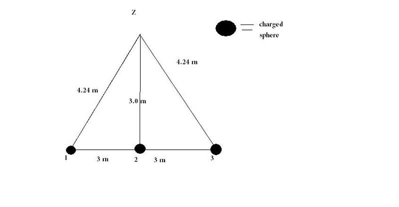

Examine the diagram provided,
Sphere 1: q=3.0x10-4C
Sphere 2: q=-3.0x10-4C
Sphere 3: q= 3x10-4C
a) Find the total electric potential energy of the charge distribution
b) Find the total electric potential at point Z
EE=kq1q2/r +kq2q3/r+kq1+q3/r... etc
V=kq/r
a) EE= kq1q2/r +kq2q3/r+kq1+q3/r
EE=(9x109)[(3.0x10-4*(-3.0x10-4)/3) + ((-3.0x10-4*(3.0x10-4)/3) + ((3.0x10-4*3.0x10-4)/6)]
EE= -405 J (Does anyone else get the same answer? I tried to do it continuously in my calculator so I don't lose digits)
b) V= K(q1/r+q2/r+q3/r)
V=(9x109)[(3.0x10-4/4.24)+(-3.0x10-4/3)+(3.0x10-4/4.24)]
V=3.7x105 V or J/C
Those answers look good to me.
Ok thanks!
Those are tough to calculate all at once. It took me a few tries but I did end up with the same answers.
For anyone else who likes to take things one step at a time, here you go:
a) E = k[(-3x10^-8)+(1.5x10^-8)+(-3x10^-8)]
b) V = k(4.15094x10^-5)
(and at the end, when your multiplying the final sum by Coulomb's Constant (k=9x10^9), make sure to put brackets around that too. Seems to make a difference.)
