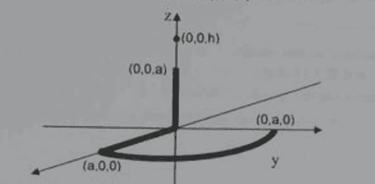

A finite line of charges has been bent into the shape shown in the figure below (2 orthogonal segments and an arc of a circle). Knowing the charge density in the line is given by ρl (C/m) get the electric potential field at the point (0,0,h). h>a
electric potential field equation
I've already tried to calculate the potential with respect to the 3 segments and then apply superposition (V1+V2+V3). However, I was not very successful. My error I think is in the calculation of the radii, mainly of the line segment that is on the z axis. Can anybody help me? I need some light on this question, please

We can help you if you show us what you did. Show us your work and where you think you went wrong. Specifically, what radii are you talking about? There is only one radius and that is associated with the quarter-circle. Your superposition approach is correct.

It's not multiple rays. I expressed myself badly, sorry. However, on to my calculations:
$$V_1 = \int_{0}^{a}\frac{\rho_l}{4\pi \varepsilon_0\sqrt{x^2+h^2} }dx$$
$$V_2 = \int_{0}^{a}\frac{\rho_l}{4\pi \varepsilon_0(h-z) }dz$$
$$V_3 = \int_{0}^{\frac{\pi }{2}}\frac{\rho_la}{4\pi \varepsilon_0\sqrt{a^2+h^2} }d\phi$$
Is what I did correct?
what is the angle between the x and y axis?
The angle is ##\frac{\pi }{2}##
So why does your integral specify integration between zero and ##\pi/4##?
Also, editing out an error from your post after getting a reply is not good form.
I ended up realizing my error shortly after sending the answer. Also, I didn't edit my answer because of your question. Anyway, I apologize for my mistake and I didn't know about this no edit practice, I'm new here. If you want I can edit the question to what it was before, no problem. I just want to clear my doubt on the question. Again sorry for the edit. Thanks
Likes PeroK and berkeman
That looks about right. What do you get when you redo the integrals as you have them in post #4 #3? Is your answer the same as you got before?
Likes Delta2
post #3 setups correctly the integrals. Now the OP has to calculate them correctly.
Likes kuruman
