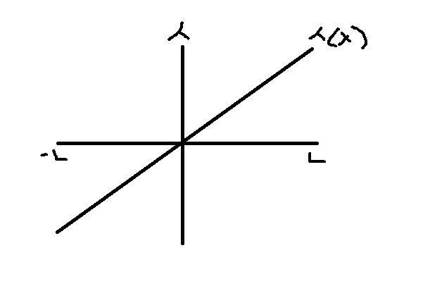

1.
graph charge density as a function of x from -L to L would just look like this because using the values and plugging it into the lambda equation it would produce these values.

1.
[see above]
Curious - your graph has varying negative charge to the left and varying positive charge to the right ... didn't the question say that the charge "uniformly distributed"?
Oh, Would it just be a straight line then?
You already drew a straight line though. What's important is the slope and y intercept.
If the total charge on the rod is Q, then the linear charge density of ##\lambda=Q/2L## everywhere along the rod right?
I was thinking the slope would be zero? so the line would be horizontal from -L to L?
That's how I read it.
