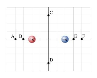

In the figure (se attached) there are two point charges, +q and -q . There are also six positions, labeled A through F, at various distances from the two point charges.
Rank the locations A to F on the basis of the electric potential at each point. Rank positive electric potentials as larger than negative electric potentials (left to right).
Anyone who knows?

What have you done so far? (You must show your work to get help.)
Well, i know that C and D have the same electric potential (because of their position to +q and -q). And B have greater potential than A, and i guess that E have greater than F.
I guess this is right because of 1/r.
If not maybe someone can explain it for me.
Good. What does the potential equal at those points?
Don't guess, figure it out. (The potentials at E and F are both negative; which is greater?) How does the potential at A & B compare with the potential at E & F?
(You're doing good.)
Hmm, well F should be greater, so the answere should be: B A C/D F E, or?
Looks good to me!
Excellent, thanks for your help :)
