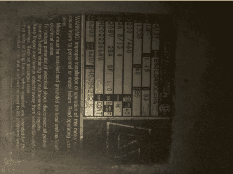

Now I’m not for sure what all I would need to start this build, and I have a ton of questions. As in what size motor and phase motor to use, what electric speed controller would be best, do I need a certain battery or will the yellow top optimas be okay to use?
Basically this is what I have so far. A 15hp 3 phase motor, 1735 rpm, 60 hz. Ill post a pic of it below. Now will this be enough power to move me in a light frame at a fast enough speed? We usually go about 100-125 ft drag strip on dirt. So I would be probably putting the motor in the middle with two sprockets and a chain to the front and back drive shaft. But basically what I’m asking is where would I start?
1. Can I even use this motor with car battery’s.
2. Is 15hp enough to move at a considerable speed?.
3. What kind (if any) converters, resisters, ie. other parts would you think i would need to assemble to make something like this. Any advise is welcome!

Ive posted a photo here of the specs of motor. I apologize if i am in the wrong forum.

Okay. Yeah that 15 hp motor is super heavy, I wasn’t sure if it would have enough power realistically to move fast enough. But with the power to weight ratio of what its going on, I know I won't need much.
IMHO, the three-phase inverter you'll need for that 60 Hz motor is non-trivial. Also, the starting torque may not suffice. Please step back and have another think.
A quick Google search shows a 500cc at 48HP.
The motor nameplate you posted shows 1HP.

It’s kinda hard to see but it’s actualy 10 hp. The motor is super heavy. I’ve been told on other forums and other people that really the hp rating on an electric motor isn’t comparable to hp out of an gas motor. And that it’s all about how much power you can supply. I’ve seen people use 30 hp motors to power small 3000 lb cars. So I do believe this 10 go motor is enough but just wasn’t sure if two-three batteries would suffice.

You still have to drive it with 60 Hz three-phase. IMHO, that seriously limits its potential starting torque.
I suspect you'd do better with a DC motor. I would peruse junkyards for the starter motor from a big diesel or aircraft engine.

1) No, this is an AC motor, batteries are DC
2) Depends on the weight and how much friction, if you are up against 600cc bike engines which have what 100-130Hp? then 15Hp is not much. Now one thing with electric motors is they can be over driven for short periods, so the 15Hp machine can maybe give you a 30-45Hp short burst. But the issue is the inverter needed, and its an induction machine so they have kind of crappy starting torque plus no doubt you'll need to make probably 208V 3phase? which is on its own not trivial.
3) I don't know how much $$ you have to burn on this, but I think the easiest would be to get brushed DC machines, for example golf cart motors and DIY EV conversion motors would work well (search for Warp 9 brushed machine and you'll get an idea). If I were doing this I'd look at 4 identical golf car motors, one for each wheel, then a big 2 step contactor (big switch) that connects bats in parallel for the first acceleration (low voltage lots of current) then once up to some speed click them into series (more volts less current).
Next step up would be permanent magnet brushless, but that's a step up in complexity as well.
