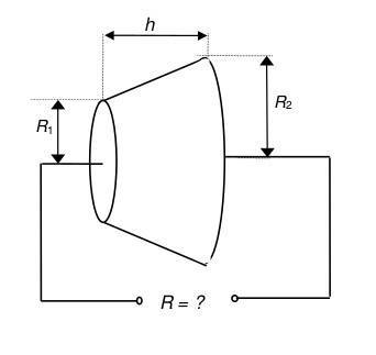

Homogeneous body with the shape of a truncated rotating cone has a base shaped like a
circle. The radius of the lower base is R2 = 8 cm and radius of the upper base is R1 =
4 cm. The height h = 8 cm (see figure). Calculate the total electric
resistance between the base surfaces of the body, when made of a material of
resistivity ρ = 4*10 ^(-2) Ohm*m. Assume that during the transport of electric charge
through the body volume, the current density changes.
see the picture

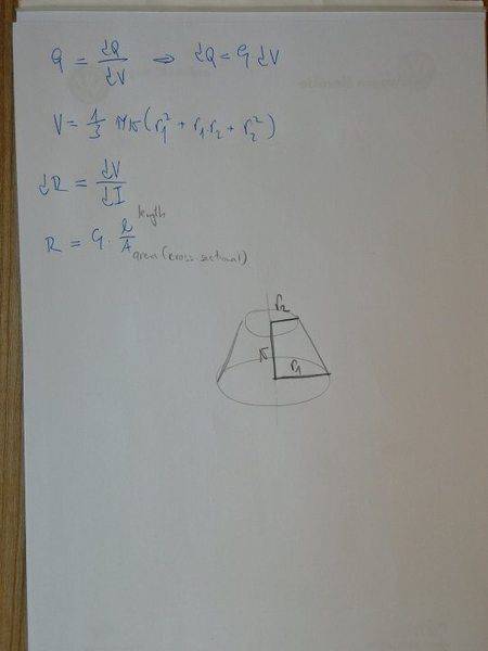

idea:
triple integration..one through the height...and the remaining ones through the radius and the perimeter...but does this take into account the changing of the radius at different heights?

Only a single integration is needed. Hint: thin circular disks.
Likes cnh1995
Write a general expression for any intermediate radius in terms of R1,R2 and h. Use it for calculation of resistance of thin circular discs and integrate along proper path.

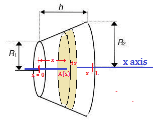

This is not what you need to integrate. The entire truncated cone can be thought of as made of many thin slices (circular disks). Each disk will have a small resistance dR that will depend on the radius and thickness of the disk. These resistances are in "series", so the total resistance is the sum (or integral) of the individual resistances.

R=ρ*l/A.. For a small disc at a distance x from the leftmost end, what is the length and area of cross section in terms of x?
Likes ciso112
In the figure below, you see a disk located at position x along the axis of the cone. The disk has a thickness dx and an area A(x) which depends on x. ( You will need to express A(x) explicitly in terms of the position x.) How would you express the resistance, dR, of the disk in terms of A(x) and dx?

Radius varies linearly with x. At x=0, r=R1 and at x=h, r=R2. Using this data, can you write a general expression for r in terms of x?

It's like a straight line passing through (0, R1) and (h, R2). How will you write r as a function of x from this data? It is in the form r=ax+b.. Now a and b can be found using known quantities R1, R2 and h.

r1 + ((r2-r1)/h)*x could it be?
dR = ρ * (r1 + (((r2-r1)/h)*x)/dA) ?
Right!

what about, dA = PI*r^2*dx?
The expression you got is for radius r.
R=ρ*l/A..
Likes ciso112
Look at Tsny's image carefully. You need to express dR in terms of dx and A(x)..
Likes ciso112
You now know radius r as a function of x. For a small disc of resistance dR, what is the thickness and cross sectional area in terms of x? Once you get that expression, all you need to do is integrate it between 0 to h.
Likes ciso112
I am not sure what "l" is, I think this is tha last think that needs clarification
if "l" is the width, then: dR = RO*(dx/PI*r^2) where r = r1 + ((r2-r1)/h)*x ?
Likes cnh1995
There you go!:smile:
