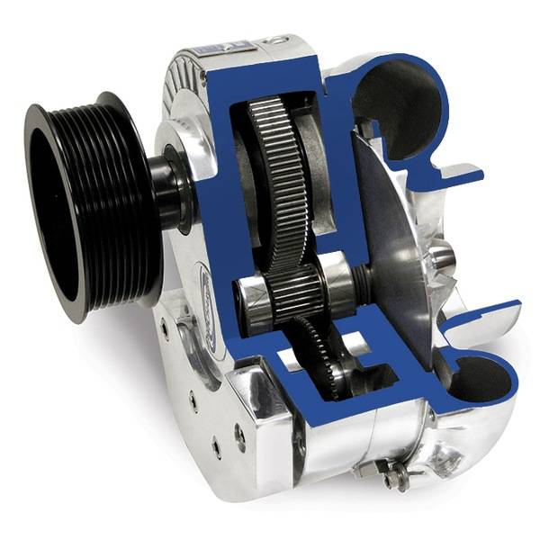

I would spline the motor into a gear up box (I know it's not ideal, but I can't seem to find any 5-10kW 75,000 RPM motors) and then the output was splined onto an additional turbocharger's shaft in place of the turbine. This is essentially the setup of a ProCharger: https://www.procharger.com/auto-superchargers/models
I would want to provide 5-10lbs of boost up from idle (600 RPM) through about 3000 RPM, while the normal turbos spool. The motor and compressor would only have to operate for about a three second interval.
