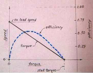

...a high torque results in a higher efficiency.
When a motor produces more torque, it consumes more current.
Efficiency = (torque * rotational speed)/(voltage * current).
If you set torque as the independent variable, and speed and efficiency as dependent variables then (for a given voltage) your graph will look like this. In addition, when the motor is first connected to the cap, current will be high because the motor shaft is accelerating from a standing start, and cap voltage is at its highest.
You could check experimentally if my hypothesis is correct by checking the voltage over the cap when the motor/mass came to a standstill, that is there will still be some voltage (which will bleed away over time), but the motor (mass) is already stationary.
