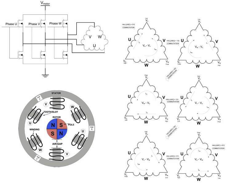

Hello,
I am writing my MSc dissertation, and I want to draw some 3-phase circuits with different cabling configurations (6-wire, 4-wire etc). I need an easy software that can draw the schematics nicely, like the ones found in books. I do not need interactive software (like NI circuit design), just a drawing software. I need it to have pre-installed star-delta connections and of course the main components.
I would really appreciate your input !
Regards,
Nik.

Can you just use Microsoft Visio? I think it has libraries of things like your electrical circuit blocks...

Hello berkeman,
I did try Visio, and I may be getting something wrong, but how can you make star connection with inductors and or loads on the star ?
Am I asking for too much? I don't know... I just assume that there should be an easier way.
Regards,
Nik.
Edit: Something like that say : http://www.linengineering.com/LinE/_images/Diagram_BLDC17.gif

I've made drawings very similar to that in Visio. Sometimes you need to make your own "components", and that is not necessarily obvious to do. I also have had to avoid making "connections" sometimes because visio's drawing rules put wires where I don't want them. Instead of treating it like a connection/schematic tool, I just treat it like a drawing tool and I get much better results. There could be a better way that I don't know though.
You can do a lot in Visio:
http://www.visguy.com/archive-index/visio-art/

Hello Dragon Petter,
Thanks for your reply !
I will give it a try creating my own. I bet it is going to be a hassle, but if there is no easier way, I will go with it...

Yes it was a hassle for me as well. Here are some of the drawings I made in visio . . they look very close to the example you're going for.
