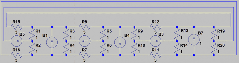

I want to transform a sort of infinite arrangement of this circuit:
The values themselves aren't important, just the representation of what's happening, all the verticle resistors are the same value as each other, and all the horizontal resistors are the same value as each other.
I just made up 1 and 3 ohms as a random example. You could say that all the current soruces are 1 A if you like.
I'd like to figure out how to transform all the current sources into voltage sources using source transformation:
https://en.wikipedia.org/wiki/Source_transformation
But my issue is that since each current source has multiple resistors in parallel with it, how can you do this?
Thanks a lot!

I suggest that you at first make a Thevenin/Norton equivalent of a "repeated group" in the circuit. Then connect these equivalents in series/parallel.

Having a quick look at your circuit, I assumed it were build by repeated groups. For example from left to right the current sources point east, north, west, south and then repeated this "pattern", so that a "group" included 4 current sources. But by closer look I see it's not repeated, because it continues: east, west, . . . . .
Anyway I hope you understand what I mean as for the direction of current sources: If there are no repeated groups, it will be very difficult to predict how the network will continue to the right towards infinity. :smile:
If the decimals of the constant π were repeating themselves in "groups", say
π = 3.1415926514159265... it would be easy to "calculate" π with a million decimals.

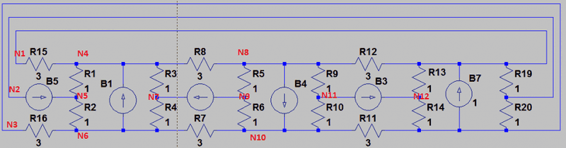

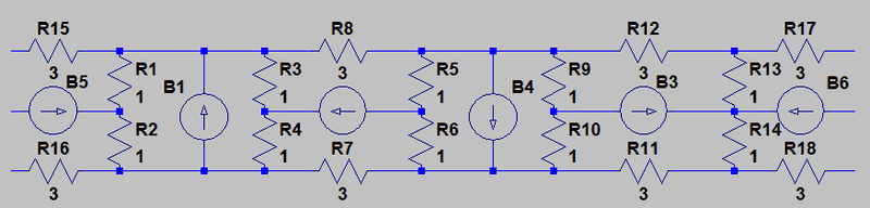

I actually realized I made a mistake myself, I just fixed it in (the following picture) and an example of one of the hypertheticals of what I meant (is also in that picture):
So is there any way to convert the current sources to voltage sources?
Thanks alot.

Well, now you have fixed the mistake (B7), but you have also made a closed loop. You have to decide: Closed loop or infinite straight network?
You will never divide the last circuit into "groups", now there is only one group.

No, you cannot convert a current source into a voltage source, but you can convert a Norton equivalent into a Thevenin equivalent.
Example: ( IN = 4A, RN = 5Ω ) → ( VT = 20V, RT = 5Ω )
What do you want to find? Voltages, currents?

There is some symmetry in the circuit, due to all vertical resistors are the same, etc.
But generally you could use Kirchhoffs current law (KCL).
If you look at a part of the circuit: ( R3 . . R8, B2 ), there are 6 nodes. Naming these as V1, V2 . . V6, starting clockwise at the lower left corner, and saying that V6 = 0V ( reference ), you could make 5 equations, thereby finding 5 remaining voltages. Here is an example as for V2:
( V1-V2 ) / R4 + ( V3 - V2 )/R3 + IB2 = 0
In this way you can find all the voltages in this isolated part of the circuit.
To find all the voltages in the circuit as a whole, you will have to make 11 equations. Note that any values for the resistors and source-currents may be used.
So name all the 12 nodes, set one of the nodes = 0V, make 11 equations and solve them.
I suggest you make the first 3 equations, then post them and I ( or others ) will have a look at them.

Oh yeah, good point(s). And thanks for the quick reply. Its starting to come back to me. Well here is a labeled picture For KCL:
let N1 = 0V
[0-N4] / R15 + [N4-N5] / R1 + B1 + [N7-N4] / R3 + [N8-N4] / R8 = 0
B5 + [N5-N4]/R1 + [N5-N6]/R2 = 0
[N6 - N5] / R2 + [N6 - N3] / R16 - B1 + [N6 - N7] / R4 + [N6 - N10] / R7 = 0
[N7 - N4] / R3 + B2 + [N7 - N6] / R4 = 0
[N8 - N4] / R8 + [N8 - N9] / R5 + [N8 - N1] / R12 - B4 + [N8 - N11] / R9 = 0
[N9 - N8] / R5 - R2 + [N9 - N10] / R6 = 0
[N10 - N6] / R7 + [N10 - N9] / R6 + B4 + [N10 - N11] / R10 + [N10 - N3] / R11 = 0
[N12 - N1] / R13 + B3 + [N12 - N3] / R14 = 0
[N1 - N2] / R19 + B7 + [N1 - N8] / R12 = 0
[N2 - N1] / R19 - B5 + [N2 - N3] / R20 = 0
[N3 - N2] / R20 - B7 + [N3 - N6] / R16 = 0
How's that? So what do I rearrange for now?

It probably wouldn't be too hard to convert a repeating segment of your circuit into a two-port (https://en.wikipedia.org/wiki/Two-port_network).
Would you care about what's actually in the two-port, or is it sufficient that the two-port contains different circuitry, maybe containing only voltage sources, maybe not, and the two port behavior at the terminals would be the same as your circuit? If that's ok, then you could cascade an infinite number of the two-ports and get an infinite circuit with the same behavior as your original circuit carried to infinity.
I'm so rusty that what you proposed more or less went over my head, could you humour me? Maybe with a picture? Cheers! (I'd like it to be finite, although an infinite circuit would still be of interest to me)
Read the full wikipedia article; there are a lot of pictures in there. Also have a look at this article: https://en.wikipedia.org/wiki/Electronic_filter_topology#Ladder_topologies
I want to tell you that if you actually solve the 11 equations which you have formulated with symbolic variables, you will get results for the node voltages which will be totally unusable. Each node voltage expression will take many lines, maybe pages. Here's what I mean, only many times bigger:
On the other hand, if you attempt a numerical solution you will get a usable solution.
What is your ultimate purpose in all this? What will you do with the solution?
I've only checked the first equation:
Starting with the first parenthesis [0-N4] you are calculating the sum of currents that flows towards the node N4, thus all the currents must have this direction:
[0-N4] / R15 + [N5-N4] / R1 + B1 + [N7-N4] / R3 + [N8-N4] / R8 = 0
You don't have to "rearrange". Just setup a matrix: As for this first equation, the coefficient in the first row will be:
N4: -1/R15 - 1/R1 - 1/R3 - 1/R8
N5: 1/R1
N7: 1/R3
N8: 1/R8
= -B1
The solution will be all the node-voltages: N2 . . N12
Is this something like the (12x12) matrix you were talking about (in Matlab):
B5 + [N4-N5]/R1 + [N6-N5]/R2 = 0
[N5 - N6] / R2 + [N3 - N6] / R16 - B1 + [N7 - N6] / R4 + [N10 - N6] / R7 = 0
[N4 - N7] / R3 + B2 + [N6 - N7] / R4 = 0
[N4 - N8] / R8 + [N9 - N8] / R5 + [N1 - N8] / R12 - B4 + [N11 - N8] / R9 = 0
[N8 - N9] / R5 - B2 + [N10 - N9] / R6 = 0
[N6 - N10] / R7 + [N9 - N10] / R6 + B4 + [N11 - N10] / R10 + [N3 - N10] / R11 = 0
[N1 - N12] / R13 + B3 + [N3 - N12] / R14 = 0
I don't know how it's structured in Matlab. It could set up by a 12x11 matrix, so that the first equation is written:
[0-N4] / R15 + [N5-N4] / R1 + [N7-N4] / R3 + [N8-N4] / R8 = -B1
But if the setup is split in two matrices, it must be a 11x11 and a 1x11 matxrix, so that the first row in the 11x11 matrix must be:
[ 0 0 -(1/R1 + 1/R3 + 1/R8) 1/R1 0 1/R3 1/R8 0 0 0 0] ( first zero removed. It would be the coefficient to N1, but you have already decided that N1 = 0, so the first column will be the coefficients to N2 ).

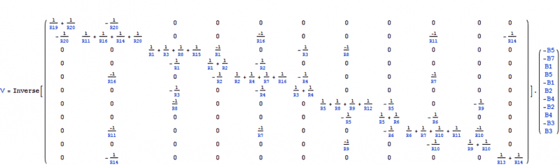

Here's the setup. I use the convention that currents leaving a node are positive. I also follow the convention of ordering the rows of the matrix according to the node numbers; that is, node 2 is row 1, node 3 is row 2, node 4 is row 3, etc.

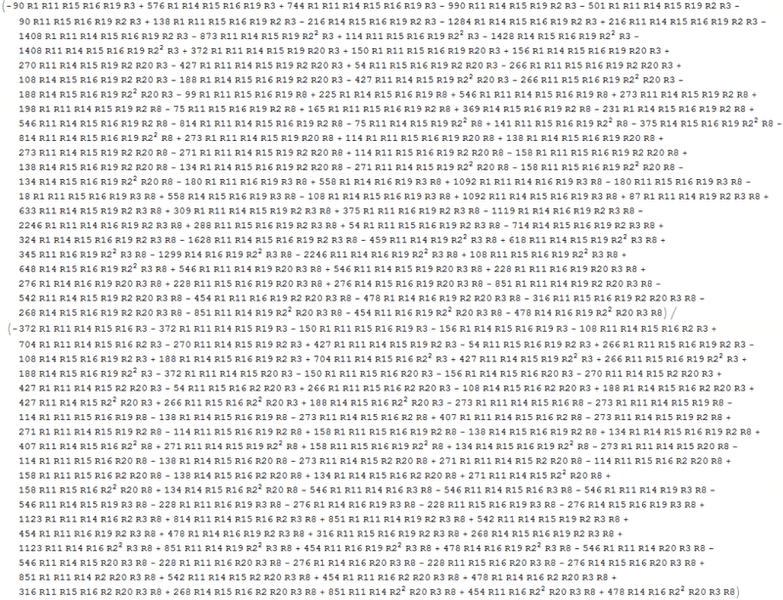

When I solve this with Mathematica, I am warned that the output is extremely large, and asks if I really want to display it.

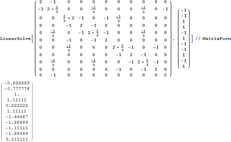

I appreciate your less ad hock approach than mine, I do like those as conventions to take. I really want to dip a toe in Mathematica, I've never gotten around to it.
So you're saying the warning indicates that the symbolic result would be so large it's not practical to re-model the circuit (from post #20) as voltage equivilant sources? Because I'm afraid of that.

You saw the complicated expression in post #22? That was from the solution where only the first 5 rows were symbolic. For the full symbolic solution, the corresponding expression would probably be 100 times larger. I don't see how anything could be done with such a thing.
You can solve the network numerically:
But even then, what do you do with the result? Just knowing the node voltages doesn't allow you to replace the current sources directly with voltage sources.

Well gentlemen, I'm sad to hear that the rearrangement is untenable. I greatly appreciate your help.
So without any 'clever' use of a trick like some sort of symmetry there is not conventional way to replace current sources with voltage sources, I find that surprising but not unbelievable. One thing I feel still needs clarification is the why? Is it because having multiple resistors in parallel with the current sources, each with a different potential (so they can't be combined) is the issue, and this is a known limitation/difficulty of the process?
Say if one was to investigate this circuit and (try) devise a method of approximating an equivilant circuit using voltage sources, if sucessful would this be a good topic for writing a scientific paper?
Cheers
  • #31
In #6 I wrote: You cannot convert a current source into a voltage source, but you can convert a Norton equivalent into a Thevenin equivalent.
I've read the whole thread:
In #1 the figure shows types of blocks in series: Type 1 - 2 - 3 - 4 then 1 - 3 ? That's not infinite repeated blocks. How to continue?
You admit that, but then suddenly in #5 the circuit becomes a loop.
The discussion continues with Thevenin/Norton equivalents, but since the circuit now has become a (finite) loop, KVL or KCL will be a more simple solution. Now the dicussion concerns whether KCL or KVL is to be used.
The thread is a mess. You must clearify what is meant.
If you want the circuit in #1 to be of infinite lenght, you must use Thevenin/Norton equivalents in series, then make a mathematical series of voltages, currents, whatever.
