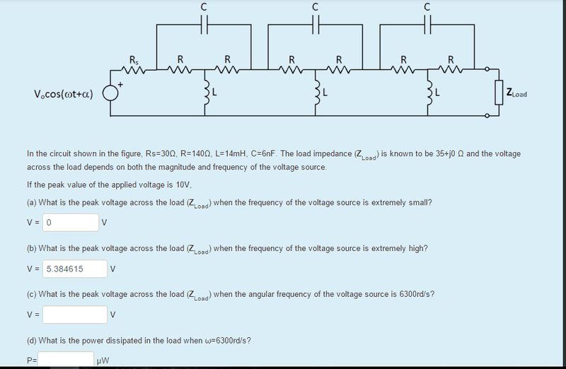

Electrical Circuits Reactive Networks Question
In summary, at low frequencies, the inductors act as short circuits and the capacitors act as open circuits, resulting in no current flow beyond Rs and a voltage of zero at the load. At high frequencies, the inductors act as open circuits and the capacitors act as short circuits, allowing current to flow through Rs and creating a voltage divider with the load. Parts C and D involve using transfer functions and calculating the resonant frequencies, but further information is needed to solve these parts.
johnwillbert82
At low voltage frequency (inductors) L become short circuit and (capacitors) C becomes open circuit
At high voltage frequency (inductors) L become open circuit and (capacitors) C becomes short circuit
Part A
At low frequency, all the capacitors are open, so no current can't run beyond Rs. Hence current at the load is zero so voltage is also zero
Part B
At high frequency, all the inductors are open, so the only path for the current is through Rs and around all the loops at the top where all the capacitors use to be (skipping all resistors)
So now it is the voltage supply Rs and the load in series, so a voltage divider can be used to workout the voltage across the load
V1 = V(Supply) x R1 / (R1 + R2)
v(Load) = 10 x 35 / (35 + 30) = 5.384615
Part C
I am assuming the angular frequency has no effect on the voltage as T = 1/f and omega = 2PIf so the frequency cancels out
This is most likely wrong
Part D
Using the same value from Part C, I would use P = V^2/R where R is 35
I think I have the first two parts correct and the last two parts wrong
any help?
johnwillbert82 said:
Part A
At low frequencies, current won't see a path through the capacitors, so why wouldn't current flow through the resistors to reach the load?
Likes johnwillbert82
Because of the short circuits were all the inductors use to be, thus the resistors and the load are isolated
At low frequencies the inductors will quickly curtail any signal that tries to take the resistor route; They'll look like shorts to ground along the path.
Parts (c) and (d) look like you're supposed to know something significant about the "unit cell" behavior, since there are three identical filter sections in cascade. I can identify them as so-called bridged T filters. Perhaps there's a property of them that allows you to use transfer function approach?
So am I right to assume since the signals are "shorted to ground", that after current passes through Rs and the first resistor, it is "curtailed" by any inductors and no other resistors or the load receives any current, which is why I put zero.
In regards to C and D, don't think I've learned about any of that yet but thanks
Yes.
That is correct, and an improvement on how you explained it earlier.
Any idea how you might be expected to attack this problem? Have you looked at something similar to it in class, perhaps calculated the bridged-T resonant frequencies?
NascentOxygen said:
That is correct, and an improvement on how you explained it earlier.Any idea how you might be expected to attack this problem? Have you looked at something similar to it in class, perhaps calculated the bridged-T resonant frequencies?
Alright thanks for the help and clarification :)
Nope, no idea at all on these, going to review my notes and lectures and see if there's anything I've missed
