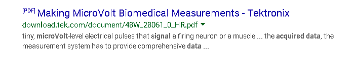

Also, are you familiar with "bootstrap" techniques for such small signals to improve S/N? @jim hardy posted about them in a recent EE thread...
be careful with this link - it puts a pdf right on your C-drive without asking.
Likes polytechnophile

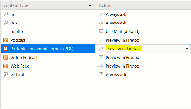

@jim hardy, that is a function of your browser settings, mine is set to "Always Ask". Other options are "Save File", "Use Downloader", "Always do this for files of this type".
Cheers,
Tom
Yes... .
Another option, if you use Firefox, is...
No downloading of anything... . :cool:
They are easy to read, also...

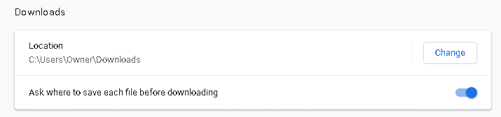

Thanks Guys ---
Firefox got cantankerous about loading Physics Forum pages
so i replaced it with Chrome
i just changed this to ON maybe that'll do it.
