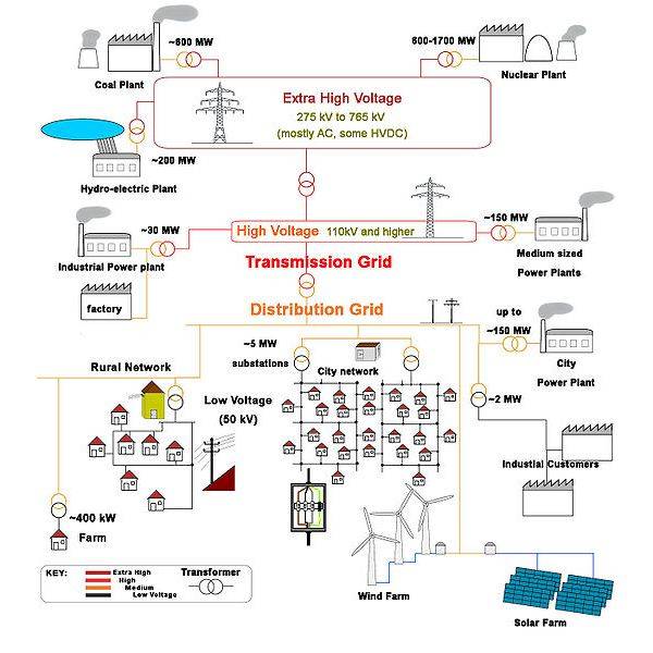

I am doing a project for a course and it asks me to draw annotated drawings of the distribution network including generators, transmission systems, distribution system and low voltage loads which in general is all fine. However, I have come across a question that asks me to draw an annotated line schematic of multiple infeeds and feeders. My issue is that I thought in-feeds and feeders were the same thing! Can anyone tell me what the difference is. I'm embarrassed to even be asking this but I don't know
Sorta hard to know what that textbook author had in mind for term "infeeder" without reading the chapter from which his question sprang.
The word doesn't appear in this GE brochure
http://www.gegridsolutions.com/multilin/resource/feeder/UniFlip_Publication/document.pdf
i'll guess he means there are multiple primary feeds bringing power into the local distribution system
Anyhow, that link should have keywords for further search.
run this by teacher and ask if it's the right flavor ?

In feeds are sources and Feeders are frequently the branch loads, at least here in the USA - another issue is that a lot of the language used is regional / country specific. Even Annotated Drawings is vague to me, We have Single Line, Three Line, etc - If I Google Image search for "annotated drawings of the distribution network" the results are quite varied, but "Single Line Diagram" you will see is much more consistent.
