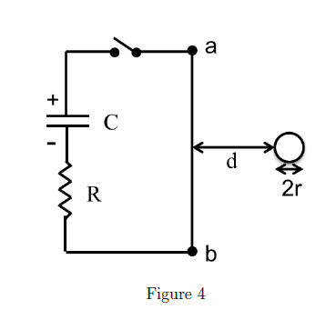

Given a coil with N turns, a radius of r, a resistance of R', and an induced current i'(t) running through the coil, determine the totale energy converted to heat in the coil for t>=0.EDIT:
The circuit on figure 4 consists of a resistance R and a capacitor with capacitance C. The voltage over the capacitor is V0 for the time t=<0 with the shown polarity. A small coil with N turns and a radius r is placed in the same plan as the large circuit, at a distance d from the wire ab. The coils resistance is R'. At the time t = 0 the switch is turned on. Both circuits are stationary and we assume that ONLY the straight wire ab, which is closest to the coil, generates a magnetic field. We can ignore the self-inductance from both circuits.
a.) Determine the current i(t) through the large circuit at the time t>=0.
\begin{equation}
i(t) = \frac{V_0}{R}e^{-\frac{t}{RC}}
\end{equation}
The wire ab is considered infinitly long and the magnetic field at the coil is assumed to be uniform (d>> r).
b.) Determine the direction and size of the induced current i'(t) in the coil for the time t>= 0.

c.) Calculate the total energy converted to heat in the coil for t>=0.
this is where the problem arises. The answer should be:
\begin{equation}
U = \frac{\mu_0^2N^2V_0^2r^4}{8R'R^3d^2C}
\end{equation}

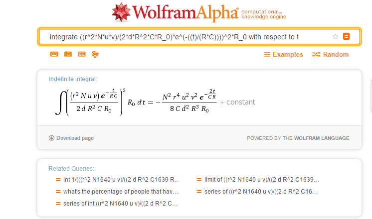

I ran it through wolfram alpha to check, and surely you were right about the exponent. I am however a little confused now because I get the following, keep in mind the i had to change the name of some things, like R' is now R_0, V_0 is now v etc.
as you can see I now have a negative value and e is still present, which it shouldn't be.
You've taken an indefinite integral, so you've ended up with an unknown constant. What are the integration limits for the time interval of interest?
Likes Erik P
I see the problem :D its from 0 to infinity, not 0 to t. Also the t isn't multiplied on the fraction, its only present as an exponent, so t=0 doesn't make the entire thing 0 it just makes the e part equal to 1 and for t = infinity we get e expression becomes 0, which means we have 0 - (above expression without the e part), so double negatives cancel out. Sorry, I guess I'm just tired... Should have caught that mistake.
