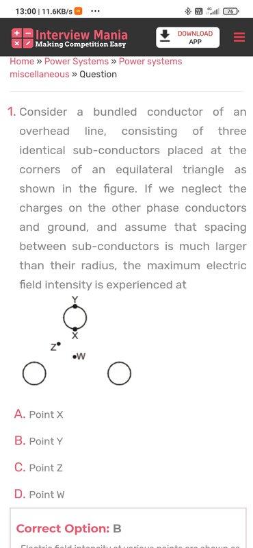

In summary: The potential at each sphere is equal to K_c\frac{q}{r}...so all three spheres are at same potential.Is the electric field in the sides and inside the triangle everywhere zero? I don't think so. Zero is only at the center of the triangle, everywhere else there is some electric field.
pranav p v
29
TL;DR Summary
This is a question that appeared in gate EE 2007.
My question is ,is there any mistake in this question?
Question clearly says electric field is produced by the sub conductors of same phase. How does it happen? If the conductors are at different potential then there will be electric field. But here those three conductors are at same potential and how does E produce ?
See the attachment

Consider three small spheres of radius ##r## each with charge q, placed at an equilateral triangle. The potential at each sphere is equal to ##K_c\frac{q}{r}## ,so all three spheres are at same potential. Is the electric field in the sides and inside the triangle everywhere zero? I don't think so. Zero is only at the center of the triangle, everywhere else there is some electric field.

It doesn't matter if they carry current, we can treat them as charged spheres regarding the potential and the electric field around them. To be more precise I see each cross section of the cylindrical conductor as a charged ring. The charges are the well known surface charges that exist in the surface of current carrying conductors.
The gradient of potential is not zero in the space in between current carrying conductors even though they are at the same potential. The logic behind this is again to treat the conductors as charged spheres or charged rings. Though the charged spheres are at the same potential, there is electric field ##\mathbf{E}=-\nabla V##, in the space in between.

Then the external corner of the triangle, point Y, will have the greatest electric field gradient.
Not all of the conductors are at the same distance to the other phases, so their voltages will be almost the same but not exactly the same.
This problem invites the student to overcomplicate, but the solution should be simple. You should not need to know the distance to other phases. You should not need to know the exact potential of each sub conductor. You should not need to know how much the current is (including zero current). To make it simple enough to answer, all those things should not matter.

I answered that question by considering like spheres of charge located at 3 corners(assumed equal charges on 3 spheres). I ignored everything as you said for the answer.
But how does that electric field produce?How can I solve that question by treated those lines like spheres of stationary charges?

In my opinion for DC and low frequency AC current the E-field outside a cylindrical conductor is like the E-field inside a cylindrical capacitor, that is the E-field is in the radial direction , perpendicular to the cylindrical conductor's surface. This radial component is due to the scalar potential, that is ##\mathbf{E_r}=-\nabla V##.
If the frequency is higher then there is also a z-component (in the same direction as that of the current of the conductor)of the E-field . This component is due to the vector potential ##\mathbf{A}##,##\mathbf{E_z}=-\frac{\partial\mathbf{A}}{\partial t}##.

As pointed out earlier, I beileve you should consider the three conductors as 3 long cylinders/spheres, all at the same eletric potential. If you consider the speheres to be positively charged, the E-field of each sphere will be radially outward.
If you add the individual E-field contributions from each sphere at the given points, you can see the E-field is maximum at Y.

The E-field is because of the surface charges on the conductor.
Look up "Poynting Vector".
