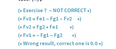

A ball with mass 144g hangs from a celling on a thread. Second ball is attached to the first ball with 20 cm thread. They both are charged with the same electric charge. How big is a force that is functioning on a thread?
F=ma

Something like that?
Fthread = Fg1 + Fg2 + Fe1 + Fe2

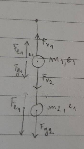

Your work in the picture is towards finding the tension of the thread that is hanging from the ceiling. However here you tell us that you wish to find the combined forced on the thread which is a different thing. Which forces are acting on the thread and from which bodies?
As I understand the exercise there are 2 forces acting on these thread, gravitational and electrical. And the sum of both is suppose to be 0.

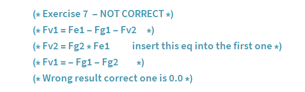

Something like that, yes. But pay attention to signs. That formula is littered with sign errors. Please show your work.
Also, please give Newton's second law some thought.
I think that this is correct?
Fthread = -Fg1 - Fg2 - Fe1 + Fe2

Nope that's wrong, on the thread that is hanging from the ceiling acts a contact force from the ceiling and a contact force from the body of mass m1=144. IF the system is in equilibrium (and hence the thread is in equilibrium) what is the sum of these two forces?
The gravitational and electrical forces act on the two bodies, not on the two threads.

Take the thread as a separate body, name it body A. What forces are acting on this body A?
2 Electrical forces and 2 gravitational forces
The electrical and gravitational forces act on the two bodies of mass m1 (and charge q) and mass m2 (and charge q), not on the threads.
You mean like that?
Fthread = Fceiling + Fbody = 0
Likes Delta2
sea333 said:
You mean like that?
Yes! simple as that since the thread is not moving the sum of forces on it is zero.
