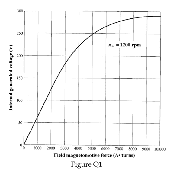

Hi guys, can someone please have a look at the following problem that I am struggling with;
An 8.25 kW shunt DC motor is supplied with a terminal DC voltage of 300 V. The armature resistance of the motor Ra is 0.25 ohms, and the field resistance Rf is 40 ohms. The field winding consists of 1500 turns. An adjustable resistance Radj is connected in series to the field winding. Radj may be varied over the range from 0 to 80 ohms and is currently set at 20 ohms. Armature reaction may be ignored in this machine. The magnetization curve for this motor, taken at a speed of 1200 rpm, is shown in Figure Q1.
(i) What is the speed of the motor when operating at rated load with an armature current of 30 A?
(ii) If the motor is now unloaded with no changes in terminal voltage or Radj, what is the no-load speed of the motor?
(iii) Iron core losses are 250 W. What are the copper losses and mechanical losses in the motor at rated load? (ignore brush and stray losses)
(iv) What is the efficiency of the motor at rated load?
(v) If the terminal voltage is reduced to 260 V and the armature current stays at 30 A, calculate the required Radj in order to restore the speed of the motor to the value in (i).
I have attempted to calculate I(f), which I am getting a value of 5A.
Also the mmf seems to be 7500 A.turns - (1500*5)
But I do not know where to go from here, any help would be appreciated.
You know the back emf generated with 1500A-T at 1200 rpm from the graph.
Compare it with the actual emf induced in the motor. With constant flux, both the emfs are proportional to the speeds.
Likes SK97
So would it be correct if I used the formula of Ea1/Ea2 = nm1/nm2
And Ea1 in this case would be 75V (reading from the graph at 1500 A-T) and Ea2 being 275V and nm1 is 1200 rpm.
So nm2 would come out to be 4400 rpm?
Thank you for your help so far.
Yes.
No. You have E1=275V (from graph) and N1=1200 rpm.
You have to calculate E2 from the data given in the problem and use the above formula to get N2.

cnh1995 said:
Yes.No. You have E1=275V (from graph) and N1=1200 rpm.
okay so using the formula E2 = Vdc - Ia*Ra
I would get a value of 292.5 V for E2.
So therefore my nm2 would be 1276.36 rpm.
Does that look right to you?
Yes.

SK97 said:
My next confusion arises with the no load speed of the motor, I'm not sure what no load actually means, and so what assumptions I can make about the system?
For a motor, no load means zero load torque. Practically, the motor generates just enough torque so as to overcome friction (and windage.)
To be accurate, you should first determine the frictional torque from the given data and calculate the no-load armature current. But that would come out to be very small. So just take no load armature current=0.
Okay, so after doing that I am coming to an equation of n2 = (I(f)1*E2/I(f)2*E1) * n1
my problem is how do I get a value of E1 and I(f)1 whilst knowing that n1 is 1200 rpm?
Because I have calculated previosuly that the field current is 5A and I know E2 would be 300 V from the information you have given me.
Yes, so you know E1=275V, N1=1200 rpm.
Now you have E2=300V, what is N2?
The field current (and mmf) is unchanged.
Likes SK97
Therefore n2 = (300/275) * 1200
Which comes out to be 1309.09 rpm
Correct?
Correct?
Yes.

SK97 said:
okay so to get T (260) is did: (260) (30) /
You have equated the 'total' input power to the gross mechanical power. You need to use the value of the back emf generated at 260V, 30A.
would i do that for both voltages? use the back emf generated to get the torques?
  • #31
Yes. Isn't mechanical power Eb*Ia?
  • #32
I think my confusion is lying in what i exactly equate at which step.
For the first step of the solution do i use the equation T = Ea * Ia / Wm
For both 300V and 260V to get the torques for both?
Then i would need to relate that to field current I(f).
So where does mechanical power come into play?
Sorry for taking this long to understand.
  • #33
To get the magnitudes of torques and the torque ratio, mechanical power is needed.
Yes, where Ea*Ia is the mechanical power.
  • #34
Okay so applying that method;
After i get the torques in the two cases is it correct for me to do this:
T(300V) / T (260V) = I (f) 1 / I (f) 2
where I (f) 1 is 5A and I (f) 2 is unknown.
Also is the Wm (mechanical speed in radians) the same for both volatges?
  • #35
Yes, isn't that mentioned in the problem?
