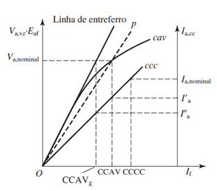

From the book Fitzgerald & Kingsley's Electric Machinery, I understand that there are unsaturated and saturated reactances.
In section 5.3.2 of the book it is said: "For operation at or near rated terminal voltage, it is common to assume that the machine is equivalent to an unsaturated one with a linear magnetizing characteristic which starts at the origin and which passes through the rated-voltage point on the open-circuit characteristic ".
By this statement, I can assume that near the terminal voltage the reactance of the generator with the unsaturated value, which is approximately constant.

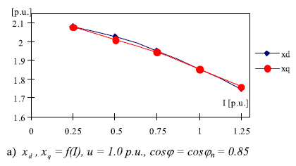

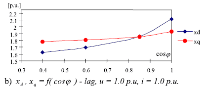

Also, I would like to add information obtained from the article "BAN, D .; ŽARKO, D.; MALJKOVIC, Z. The analysis of saturated reactances of the 247 MVA turbogenerator by using the finite element method": The saturation of the machines is different for each operative point. The values of the synchronous reactances in steady-state are to armature current, terminal voltage and power factor. In the figures below are shown the direct and quadrature reactances in function of armature current (I), power factor (cos phi) and terminal voltage (u).

lcr_melo said:
Summary:: What is the impact of increasing power system loading on generator reactance? Should we consider synchronous generator reactance constant for each loading solved by power flow?
Yes that's right. We typically do not change the reactances dynamically in a simulation. The entire synchronous generator model is linear except for saturation dependent on field current.
As you said, terminal voltage is approximately constant. Also frequency is approximately constant.
The only exception is when we study loss of synchronism which leads to extremes in voltage and frequency.

Now I am considering two cases:
i) In a heavily loaded system where terminal voltage is approximately constant but the armature current increases. Can I assume that the reactance decreases? (I'm saying it based on the article I mentioned, but I don't have any book with this information)
ii) When generators' reactive power limit is reached the terminal voltage isn't constant. In this case, the armature current is increasing and the terminal voltage is decreasing. Can I assume that the reactancead a decreases?
I would like to read a book talking specifically about this topic, but I'm not finding one.

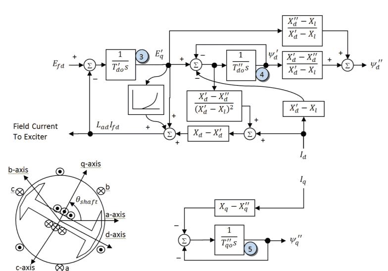

I can tell you that in system studies, load flow plus transient simulation, we do not vary the impedances with operating point. The one exception I mentioned is in the field current. Extreme, overvoltage, overcurrent, and overfrequency conditions excepted.
In a model as below. All those X and T values are considered to be constants.
