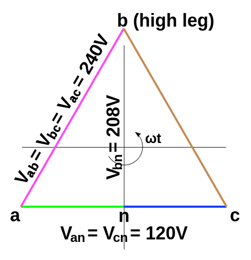

Looks to me like you have a High-leg delta setup.
I don't think I have Delta, because then if I measured pole to pole, I would get 240, but I only get 208. If I go pole to neutral I get 120
