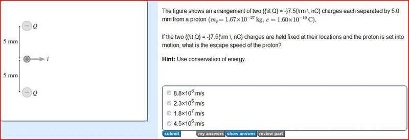

electricffiled..calcuate escape speed! urgent please help
ke=1/2mv^2
Ue=Eqs
E=kq/r^2
Uf+kf=Ki+Ui
Uf=0 and Kf=0
so -Ui=Ki
Eqs=1/2(mv^2)
v=(sEqs/m)^1/2 after this no clue i got lost help please
sry guys is the answer 2.3x10^6m/s
Yes, it is.
